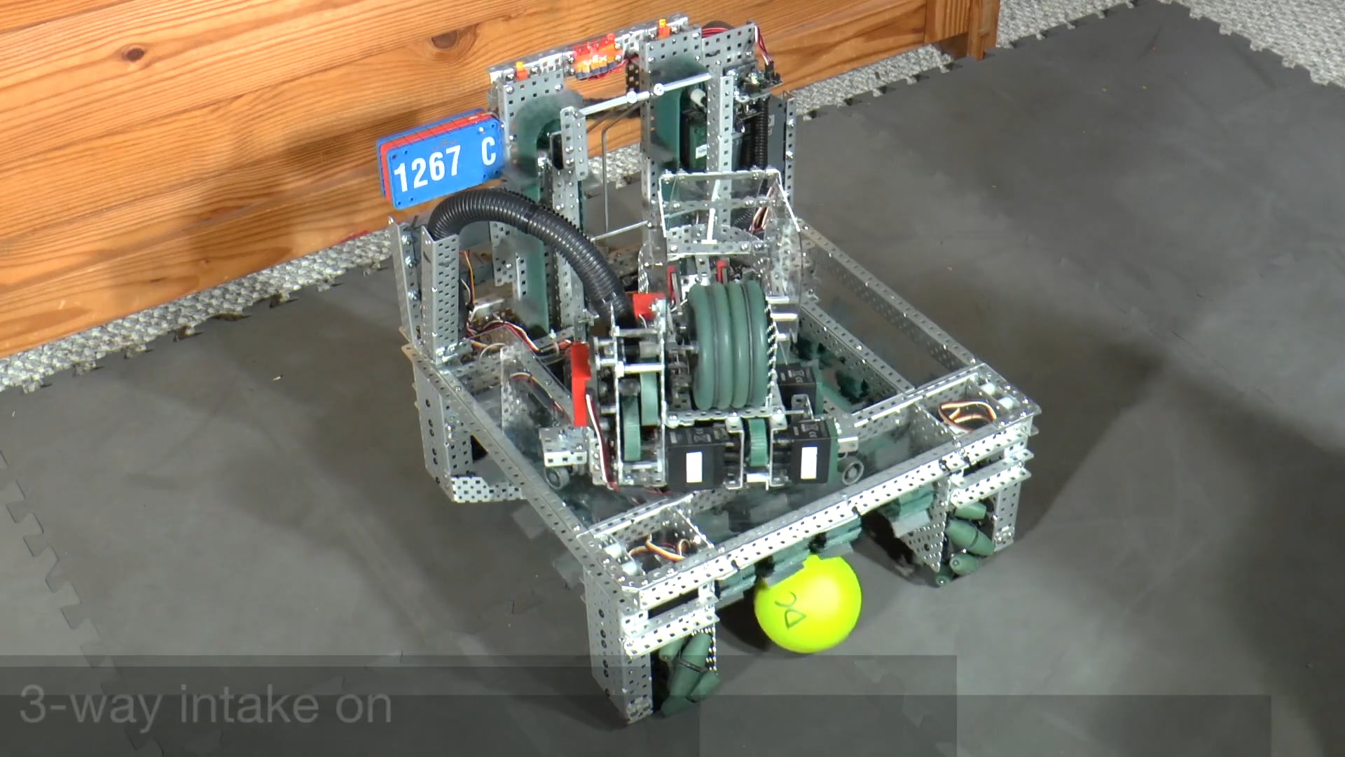

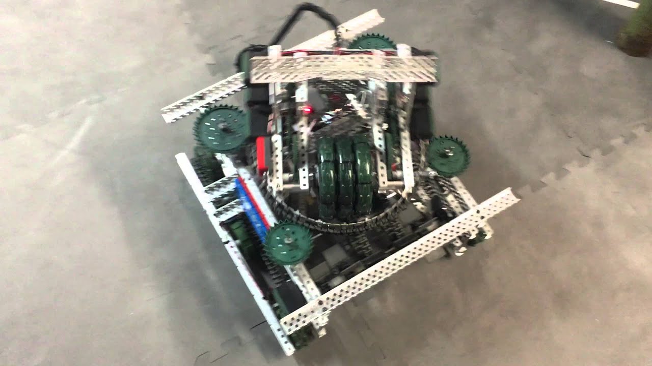

And there was also 1826 who used odometers and complex sensor usage to dynamically change the turret position and flywheel rpm as the robot moved around the field. And I bet now with the vision sensor (and other, non-VEX sensors like the Limelight for VEXU) teams could leverage both that and odometery to have an auto-aiming turret. But honestly with the amount of defense in this season’s game, I’m not sure how viable they are going to be.

It appears @RoboCatz beat me to the fuze, but here are two turret bots that were built in NBN
