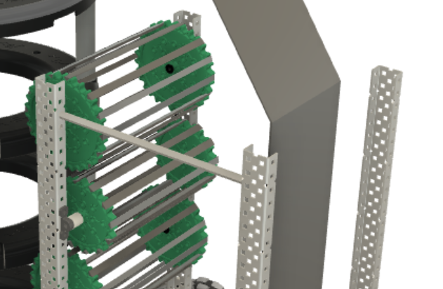

This is a question I’ve had for a while: When it comes to designing in VRC, is it better to use Standoffs or those fat white spacers for structure? Now obviously, standoffs are better for connecting things farther apart, but would it be better to use spacers:
Or standoffs:
Screenshot 2021-04-09 201532
for this specific example?
And is there a time when it’s better to use standoffs than spacers, or vice versa?
Spacers (even the 0.5" OD ones) can squish down if you tighten hard enough, but they provide a very large amount of surface contact area when mounting.
Standoffs are rigid and can (practically) not squish, but you run into the risk of them caving the actual hole if you don’t use a steel washer, which can mess with the desired spacing.
Entirely depends on what the situation is and what is required, but generally speaking I use 0.5" OD spacers for small distance bracing, with standoffs and steel washers for longer distances.
I think that in a scenario like that, using standoffs would be better. By tightening a standoff very tight, you can eliminate that slop between a screw and the hole more than you can with a spacer. The standoff will weigh ever so slightly more, but the rigidity is worth that trade off in my opinion. Also since standoffs don’t compress like spacers do, you can really tighten those screws a lot more than you could the spacers. If you do both types right, the difference will be pretty small, but I believe the standoffs should be better. (I have not objectively tested or proven this, so this is just from my experience)
Of course, when mounting a piece like in this example, the biggest source of flex in your structure will come from that bottom c channel itself, to vastly reduce that you would definitely want to have box bolts going through the whole c channel. That would be a much more important part of this particular attachment’s robustness than the spacer vs standoff decision.

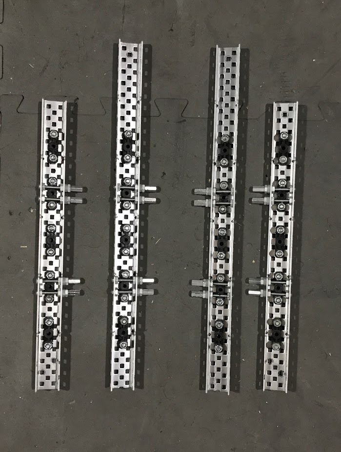

Forgot to mention, but we do this a couple of times too with using aluminum nuts to lock down the screw and spacers (or standoffs depending on the distance) for mounting.

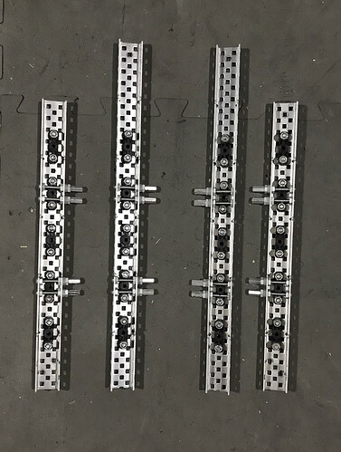

We specifically use this for the bottom channel braces on our base to enable us to easily take off the outer drive channels for maintenance or fixes as the actual hardware can remain on the outer drive channels with only screws holding the bottom channel in. Pic for reference below:

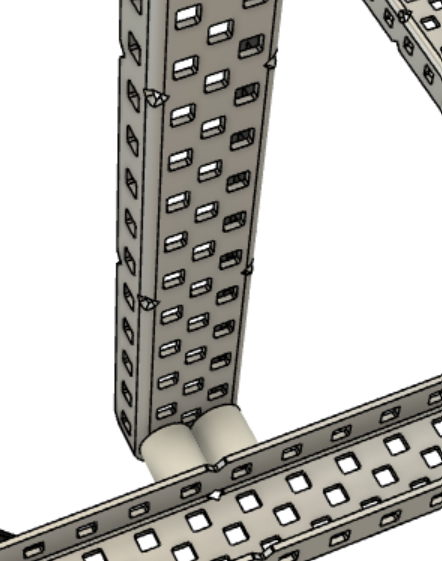

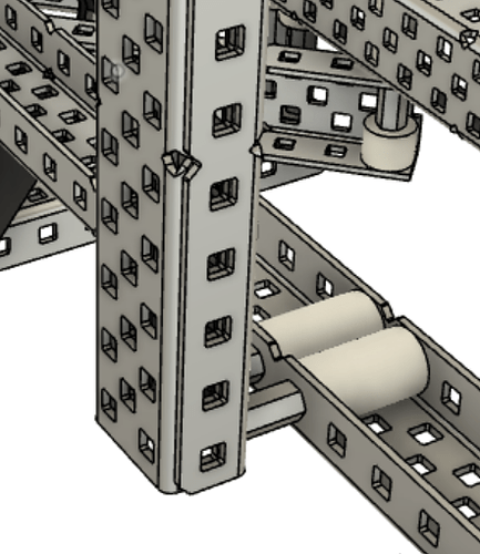

This better?
The c-channel is boxed near the attachment points, and the spacer is boxed all the way through.
I mean the c channel on top probably doesn’t need to be boxed unless it’s an extremely high load bearing piece of structure, or you don’t really care about weight and you just want the strongest build, but the box bolts on that bottom channel are pretty crucial.

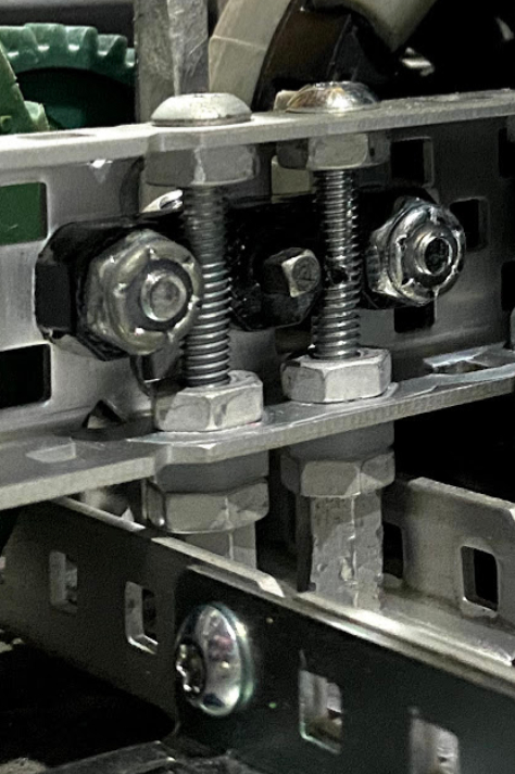

Aluminum nuts are negligible in weight savings compared to using spacers, but the main reason we used aluminum nuts there is due to bearings being in the path of the box. Because of that, we drill out the bearing horizontally to make room for the screw to pass through, with the nuts being tightened against the metal to prevent it from bending in. Keps nuts can very much be used there, but there is no real difference as long as it is tight.
In regards to spacers, 0.5" works fine a majority of the time unless you want a narrower OD due to space constraints. Personally, I wouldn’t go lower than 0.375" OD (the robosource link that @Xenon27 has in his post).
Alright, that makes sense. I had looked at the images you had provided, but I thought that they weren’t only around the bearings. Wouldn’t just space boxing just around the outsides of the bearings work too, though?
Correct, using spacers in areas where bearings (or any obstructions really) are fine. We personally use either custom length 7/8" 0.313" OD spacers or a combination of 0.5" OD spacers depending on if there are screwheads that may cause issues.
