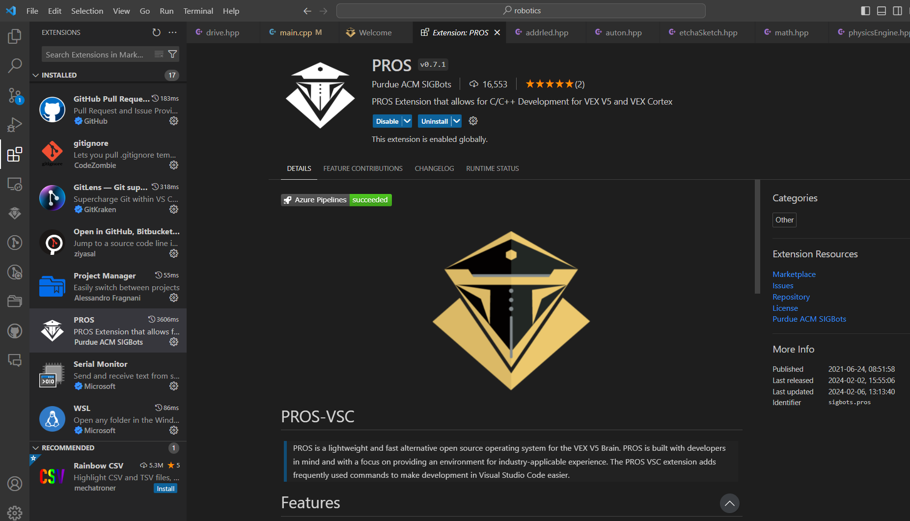

I’m using PROS in VSCode. I have PROS Kernel 3.8.0
Ok, but is the V5 vexos firmware fully updated to 1.1.2 ?
How do I check that?
This is the only VEX related extension I have. In the changelog tab I can see a version [0.1.2] but that was in 2021-11-18. The most update in the changelog was [0.6.0].
From this post: Required V5 VEXos for VEX Worlds 2022
Yes, I have VEXos 1.1.2

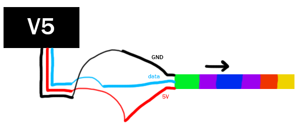

We have tried switching the ADI port. As far as we can tell the initialization doesn’t finish running, maybe because the LEDs are set up wrong? In the code I have them in Smart Port 22 because the docs said that 22 is interpreted as no Smart Port. From Arduino testing; the red wire is data, white is 5V, and black is ground. Is there anything else we can do to try and fix it?
According to Sylvie’s led guide, this is wrong. Addressable LED Control on the V5 | sy1vi3
Red is 5v, white is data, and black is ground.
wiring_diagram
