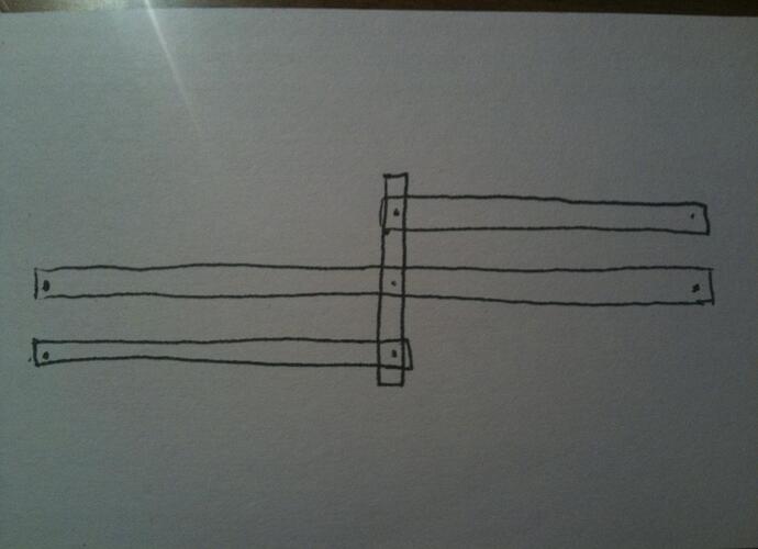

Hey, im a bit confused on how this complex four bar linkage works. Since my team was thinking about different lift mechanisms that would be effective, i wanted to use something like this, i just dont full understand how it works exactly. :frowning: would someone care to explain.

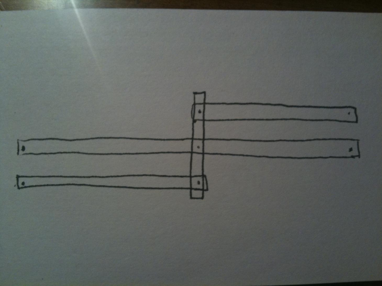

It’s pretty simple. Basically, it’s a four bar link with another four bar link stacked on top of it.
I attached a quick sketch I made that shows a side view. There are three horizontal bars. One shorter one below, a long middle one and another shorter one on top. The bottom and middle both pivot at the back of the arm. The middle also pivots at the front along with the top one. They are all connected together with a vertical center bar.
I hope I explained that well. If you have any further questions feel free to ask.
-Adam
Thank you for explaining that, Adam! :slight_smile: I think you explained it perfectly.
~Jordan
Hey that explaination helped a lot, i just have one more question. In the sketch that showed the side of the “double four bar linkage”, which bars are being driven by motors, and how many motors are recommended for this type of lift? Also which bars are “free” with no motor on them? And your explanaiton helped a lot and thanks. :slight_smile:
