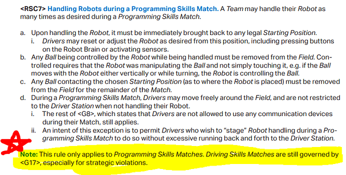

With skills, you get to reset on the other side of the bar, so if they can move a little faster, then they may be able to max skills with this bot.
They can strategically reset for programming, not driving. They will have half the field for driving if they can’t go under (or over) the bar.
