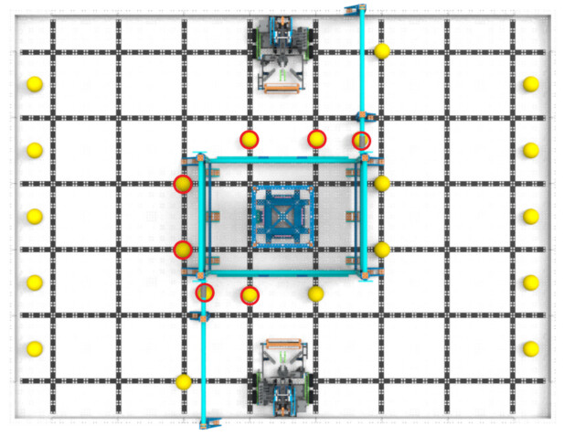

It actually missed quite a few. I count seven that it missed (you can’t see some of them, but the setup is supposed to have them, and he didn’t pick them up). I’ve highlighted in red the ones that he missed.

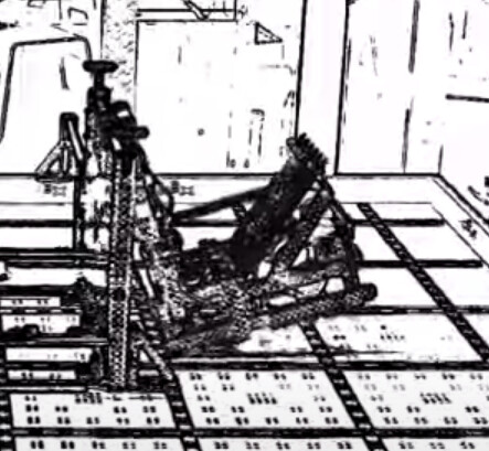

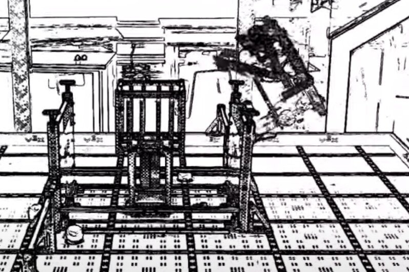

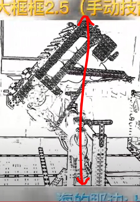

One more thing that I noticed is this robot is well out of sizebox when it climbs. Before I go on, I do want to say that it is a cool design, and it could very well have potential. Back to my point, if you look at 0:48, it is obvious that the robot reacts off of the bottom bar as well as the top bar. Additionally, the fact that the plastic sheet doesn’t deflect or bend at all, something that would certainty happen if it was reacting off of it. My point is that since the robot is reacting off the bottom bar too, it has not a whole lot of room past the top of the goal to fit 15 balls, a drivetrain, and more (~6" to be more clear). So if you look at 0:54, the robot (~19" long for reference) is quite a bit more than the allowable ~6" above the top rim of the goal. Again, while it is a cool design, this particular robot is illegal. So while I do this it is a viable design, this implementation of it isn’t quite so.

Sorry, the wording in my post was unclear. What I meant was that it was out of sizebox whether the sizebox rotates with the robot or not. If you imagine the robot inside a 19" long x 11" wide x 19" tall cube where the base 19" of the cube is the bottom of the robot, the part where the robot extends down to the bottom bar is well outside of the cube, meaning out of sizebox too. This is what I meant by that you only have a few inches of room past the top if you react off the bottom bar. Another thing I’d like to point out is that, if the sizebox rotates wit the robot, it’s going to be very hard for inspectors to correctly measure the robot.

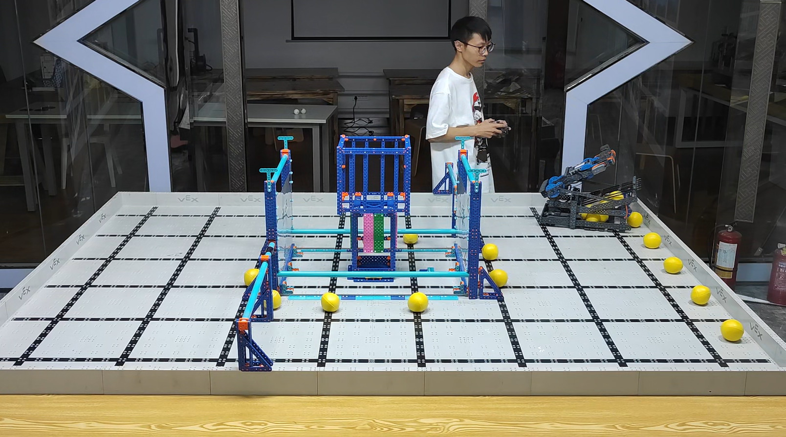

In addition, I am also very concerned about the issues discussed, especially whether the size box can rotate. To solve this problem, I have solved that the horizontal direction will not exceed 19 "at any time, but the vertical direction will exceed (unless the dimension box can be rotated). So I’ll study the ejection robot next, just in case.
At present, my folding robot is basically like this. When folded, it can hold 11 balls and can easily walk through the low bar. After deployment, 25 balls can be loaded (although not necessary). It only takes 8 seconds to hang the high pole. Complete the full score of the whole game, about 50 seconds.

That is a very clever use of using your two motors on the front arm of your bot. The lower motor solves two problems, getting under the low bar and keeping it tight against the wall to avoid the width problem. If you programmed it appropriately, it would even go way faster but not even needed. That’s slick. I had to watch it three times.
I assume the height problem would happen right here:

Im just so frustrated w/ this design. It feels really great, but I just dont want to build it out of fear that it might be out of specs when dumping.
I sure hope this is addressed on the 8/31 update. Would be nice to know if this is a path worth pursuing as we wind up our in school activities.
I 100% agree, although I’m not sure which way I’d want them to rule. On the one hand, if they ruled this legal, the game would be broken and no fun to play at the high level because it’d be like Change Up skills. On the other hand, if they make it illegal, they are putting down all these teams’ hard work that went into a robot like this. But then the game would still (hopefully) have some room for variety and improvement with the robots.
I’m with you on this one. I’ve done some experimenting with this style of robot and haven’t gotten it to fit in sizebox (provided it rotates with the robot) although I’m not convinced it can’t be done.
