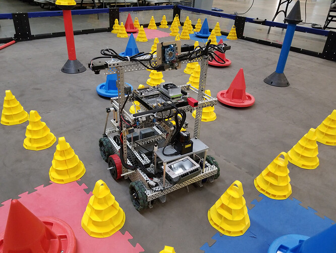

When our VAIC team first considered how to approach this game that exact question was raised. Without knowing about the goal states and robot positions of both alliances you’d quickly end up with unplanned or messy outcomes on the field. If you don’t crash into them they’ll crash into you!
Our approach to VAIC Change Up was to mimic the human visual experience, i.e. a person standing looking at the field, and pass that data to a single robot that performed scoring duties. 24" static robot with a mast and 15" scoring bot. Nothing went beyond prototyping however since there’s no possibility of our team attending an event this season.
The Change Up game design is tailored towards human players. VAIC would be much better served with a game tailored towards AI otherwise you’re always going to want to “see” and that drives the need for 3rd party solutions since the current focus of VEX AI sensors is only game object recognition and position. Disallowing 3rd party electronics and sensors would not be positive.

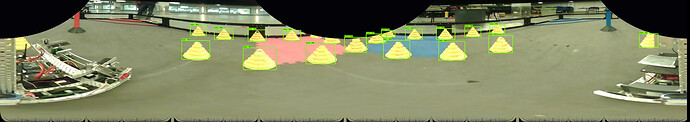

Seems like a good time to throw up some stuff from an old robot of mine.

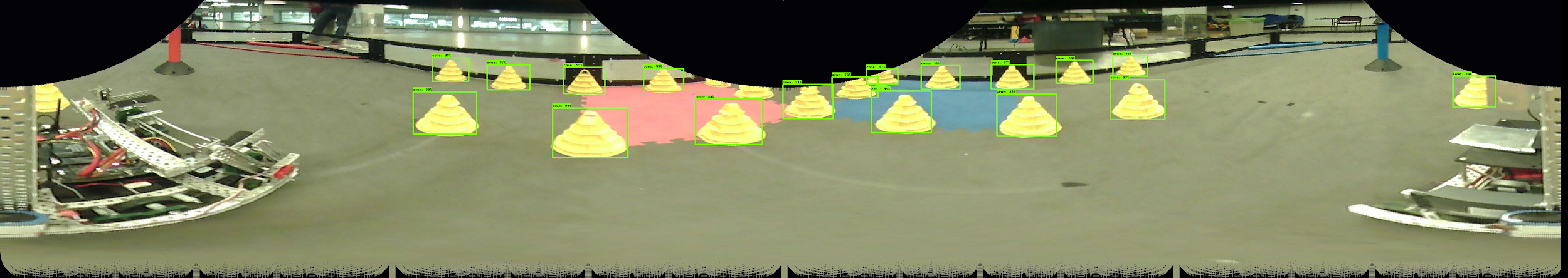

You can see the value of a high FOV camera, 360 degree coverage of the field.
Can you post what camera you used?

Really just a generic USB fisheye camera.
That is effectively an updated version of the sensor I used here
High FOV is important for VAIC to work well, teams should be able to explore these different sensor options.
