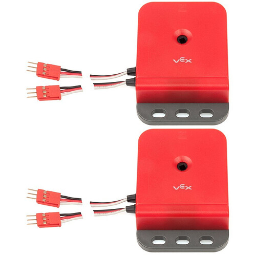

Wait for the encoders for a tracking wheel, are they the v4 type? Can someone post a picture of the encoders they use on here?
Thanks!
We are using the Optical Shaft Quadrature Encoder. Not sure what other encoder you’d be using for tracking wheels. Probably shouldn’t be using integrated encoders for that usage. And you really shouldn’t be using potentiometers for wheel tracking either.
While the structures provided by OkapiLib may be useful for autonomous programming, you don’t need OkapiLib to do this. FWIW we implemented the tracking system before V5 or OkapiLib existed. If your goal is to learn how the tracking system works and implement it, I’d recommend going over our document and code release, and attempting to implement the same math in PROS on V5. If you’re having any trouble understanding the math or code, I’d be happy to help clarify (I’m aware that the document has plenty of room for improvement and the code has plenty of room for more comments).
I think there was some black encoder the looked like a v4 motor?
Although I could be mistaken.
V4 Motors can have integrated encoders if that’s what you’re talking about.
I can’t recommend it for this purpose though.
We have found that the integrated encoders are not as accurate to work with.
