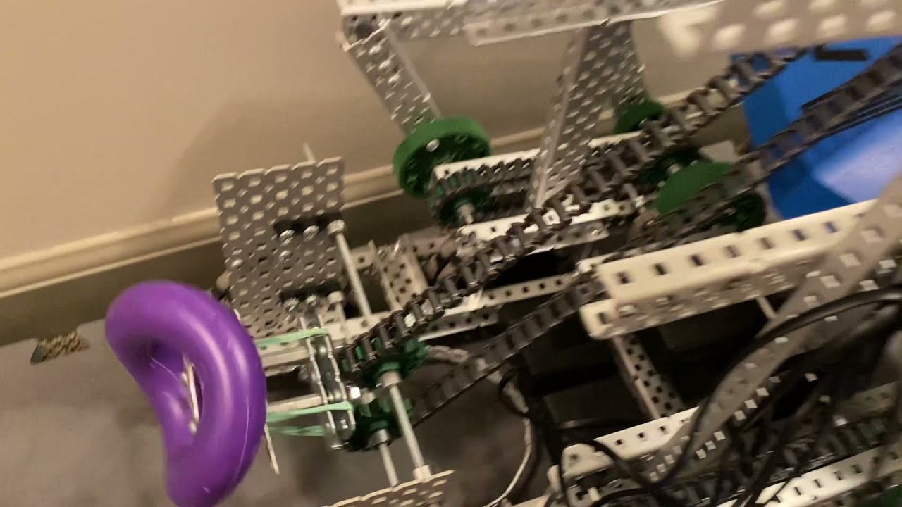

I’ve encountered some problems with the type of ring conveyor I was working on and I think I have a better solution, so I’m going to post and explain the conveyor I had in the case that someone might be able to adapt it and improve it.
In my quest for an efficient conveyor-type ring intake, there were 3 requirements I had in mind. It needed to be able to field rings, and score rings both from the front and back end of the conveyor. I tried many things, but the common problem they all had was a lack of control over the ring’s movement. They all just sort of flung or dropped the rings, without acceptable reliability, because they all just lost control of the rings too early.
So I came up with this conveyor that remedies these issues by locking the rings when they go around a bend in the chain. I do this by having 2 standoffs right next to each other on separate links, and when the links curve around a bend, the standoffs spread apart and lock in the rings. What this let me do was retain full control of the rings until the very moment they fall onto the goal branches. The nature of the standoffs also meant that each prong could hold 2 rings, doubling the ring capacity and scoring speed.

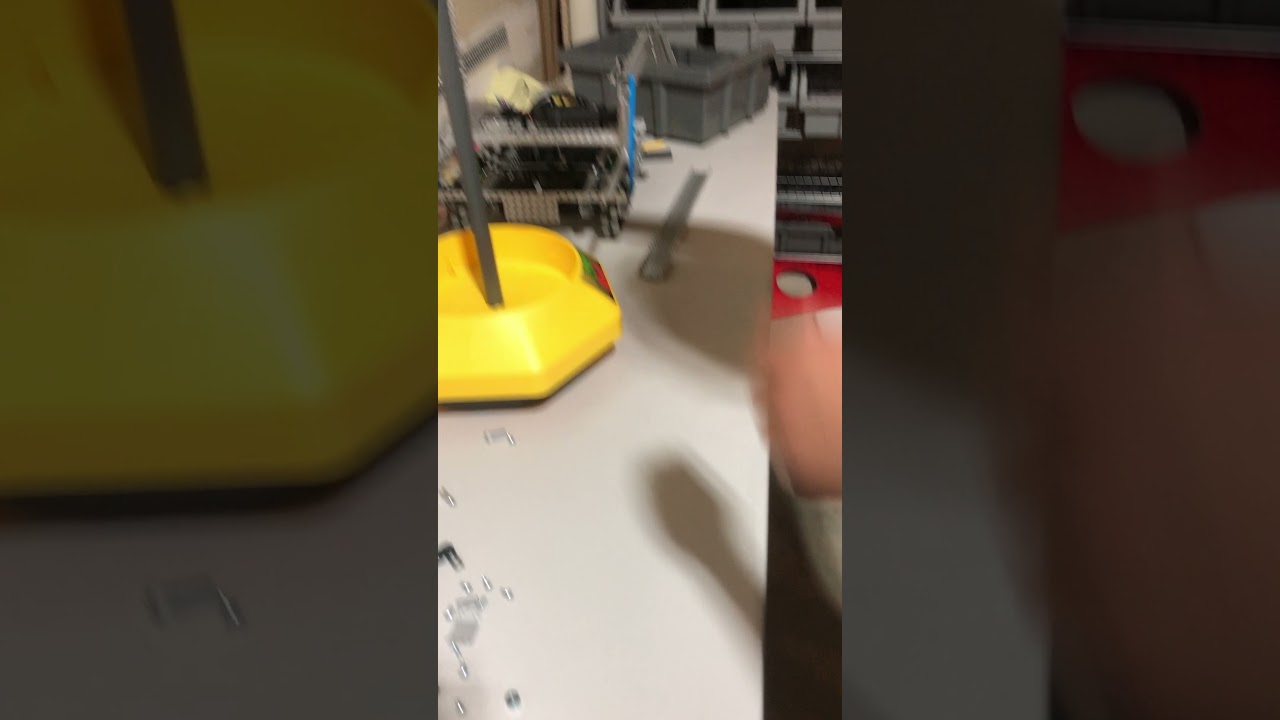

See a video of it in action. (you might have to open this link in a new tab, something funky seems to be going on with the video embedding as an image instead of a video, not sure why)
One issue this design had was that it could not field by itself, so it required an external roller that would grab rings, raise them, and then drop them onto the bottom-most prong of the conveyor. This was prototyped as well, and it worked just fine.
But when trying to CAD a robot around this conveyor system, I ran into a lot of issues.
I’m attempting to make a robot that can do everything the game has to offer at fast speeds, and this conveyor design was severely impacting my ability to do other aspects of the game.
The bulk of it, as well as the requirement of an external intake and a tall lift meant that it took up more than a full robot of space. Which means I would have had to have countless deploys to fit everything in size. It also used a lot of motors, since the conveyor and intake had to be independently controllable, on top of the already high motor cost of a tall lift and a goal rotator. I didn’t think it was realistic for a robot to use this style of conveyer when it also had to do other things, like externally lift goals, so it was scrapped in favor of a different design that accomplishes the same thing but in a (hopefully) more compact and efficient manner.
But maybe this type of conveyor has some application this year, it seems to me to have a lot of potential, and hopefully someone can find some way to make use or at least learn from it.
