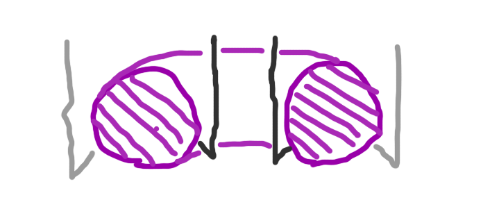

Hello Everyone, I’m the CAD designer on my team (929V) and I’m trying to build an intake for the rings that can be mounted to the end of a lift (probably a 1-bar, chain bar, or 4 bar). I want to build a plunger mechanism but I can’t seem to understand how it works and how to build it. Does anyone have a cad file or drawing of how it works or any ideas on vertical intakes I could mount onto the front of a lift. Thanks! All help is greatly appreciated!
I doubt anyone’s going to give you a cad file (both because people typically don’t give CAD out, and because very few people probably have a plunger intake CADded that they know works)
But I can give you the general idea of how a plunger works.
basically you need to have some sort of one way gate for the rings, where they can freely travel up the plunger, but can’t fall back down out of it. Think of it like a sort of linear ratchet.
here’s a sort of cross section sketch of a ring getting grabbed by 2 different types of plungers (an inner, and an outer one). They work pretty much the same way though, some sort of barb or protrusion can slip into or around the rings, and then it sticks out and prevents the rings from coming back out. This is a pretty common type of passively grabbing mechanism used on basically every game with any object other than spheres. This year I imagine it’s probably pretty fiddly to get those barbs right, since the curvature of the rings lays pretty low to the ground. The distortion in their shape probably helps though, since there are higher points in the ring always.
The second part of a plunger is the release, you need some way to retract or move the barbs in a way that allows all the rings to cleanly fall out. This can be pretty easy though, you could attach some string to a piston pneumatic cylinder, and have it so when the cylinder retracts or extends, the string pulls the barbs flat.
One thing I will say about plunger intakes is that they probably won’t be the move this season because of some significant tradeoffs they have with other types of intakes.
  • They’re going to be slow at fielding. Plucking rings precisely one by one is slow. You could remedy this by having a fielding roller attached to your base that funnels rings into position, but that is extra motors and complexity.
  • You lose vertical height. Because the plunger protrudes downwards, you’re going to be losing some amount of verticality. If you have a tall enough lift this doesn’t matter, but it does force you to make a 2 stage lift at minimum if you want to stack on the tall goal. (see norcal’s bot).
  • It requires you to be able to move the horizonal position of the plunger if you want to be able to internally and externally stack. What I mean by this is that if you want to be able to both put rings on a goal you’re carrying behind you, and rings on a goal in front of you, you have to be able to move the intake horizontally. Norcal’s four bar + chain bar combo deals with this nicely, but again, it means you need a 2 stage lift.
It does have its advantages though. It stores rings in a very light and compact manner, and it has pretty much ideal depositing time. So I don’t think it’s not viable, I just don’t think it will be the best.
