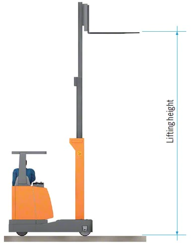

I like the idea that @EthanZhang showed, you would just need a mechanism to feed the ringles onto the branches
forklift
hmmmm…
looks like a chain cascade lift to me
WHAT HAVE I DONE!
