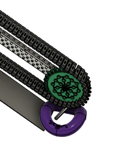

Ignore the wonky tread.
As for wheel choice, these posts aren’t like the goals in CU or in TT- you can only score on one side, on the elbow parts. I’m thinking mecanums so you can strafe over to that side, but still have enough torque to get on the platforms.

So maybe you could use like a chassis rail or something attached to two different tank treads linked together.

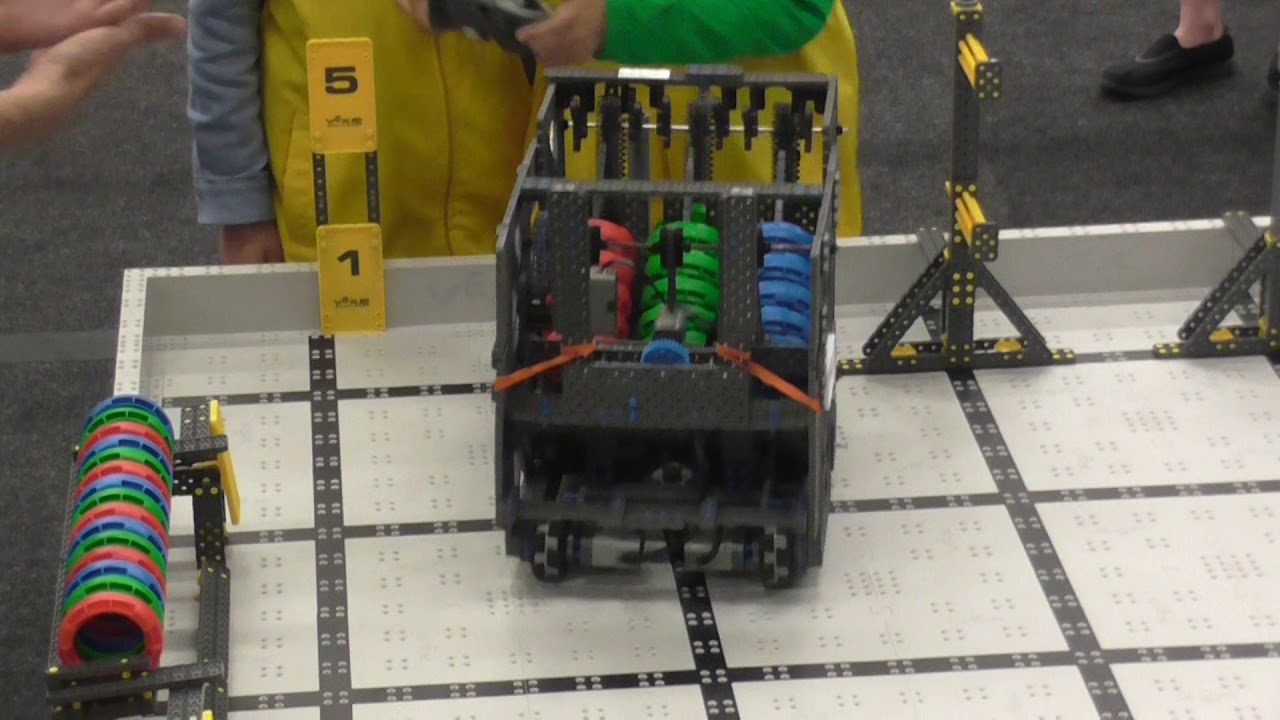

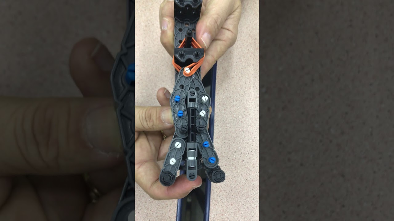

I think a good starting point would be looking at some designs that are used in VEX IQ Ringmaster
This has good opportunity as a starting point:

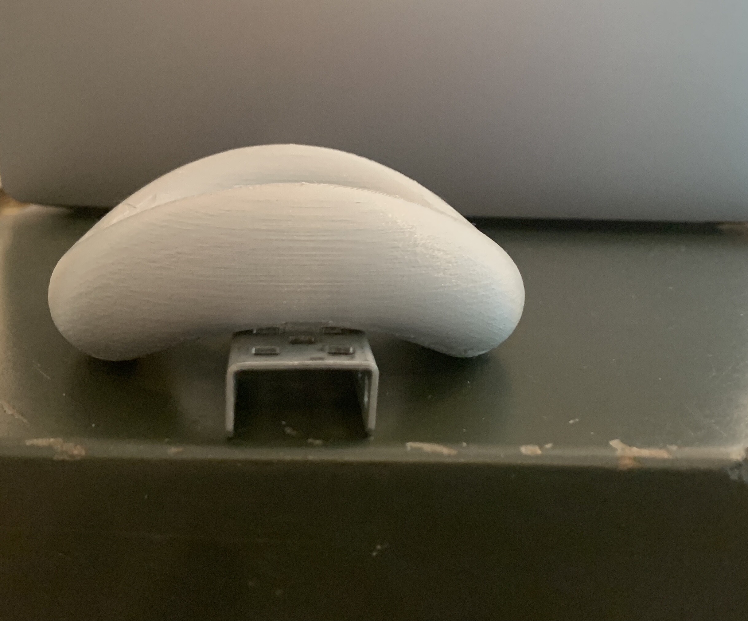

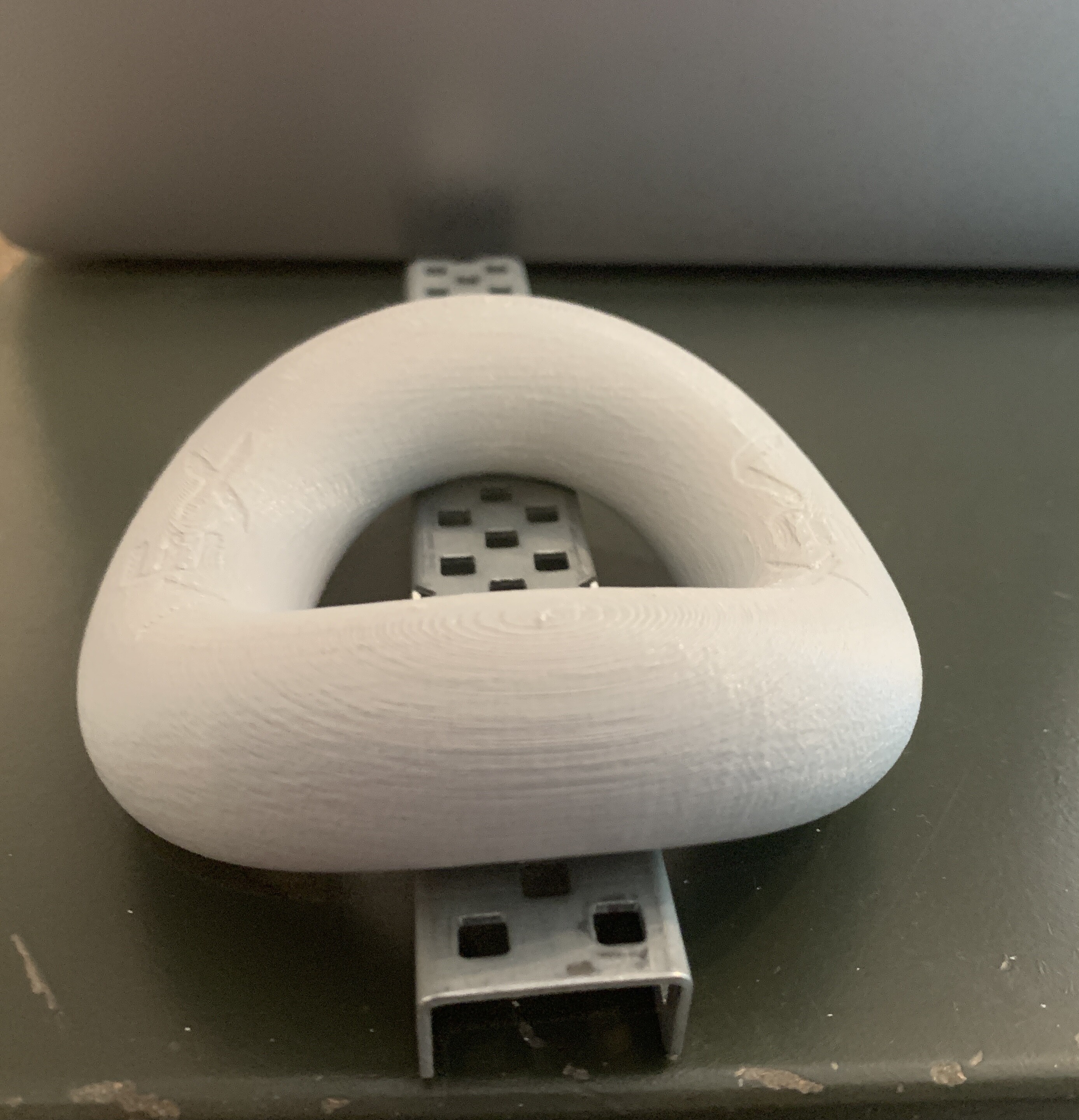

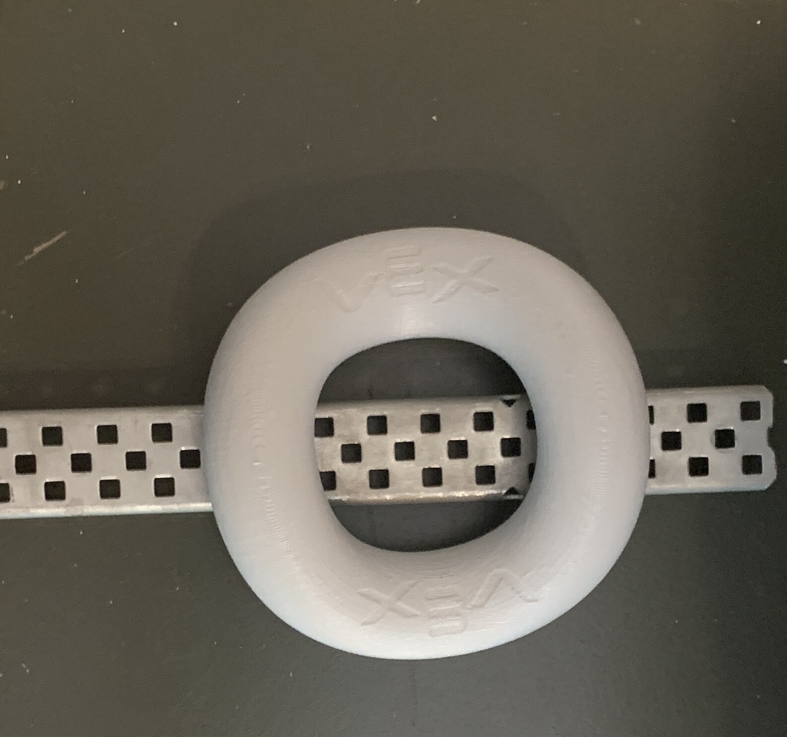

See, that’s the problem. The rings are pringle shaped, so it’d be hard to do that. I still think it could work. I was hoping no one would post this because I think it could be very viable. This is what I did ringmaster season, and it worked
At the same time
The rings are bigger than expected so you have some room under to grab them.

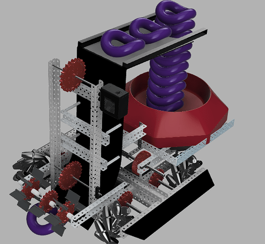

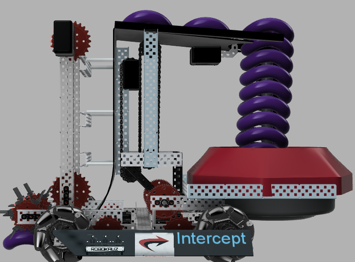

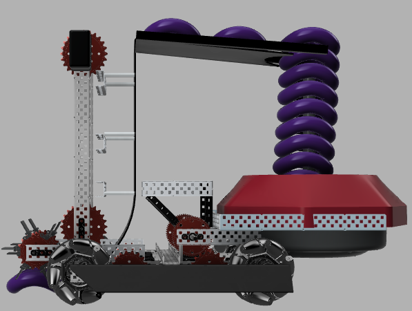

Just half formed thoughts
My initial thoughts, a Ringmaster robot mixed with an ITZ MOGO lift.
2021-05-23 (3)
dn is the meta (20 chars)
Nice! Would it be able to get high post?
It would be able to get the high posts with some modifications and the two extra motors or Pneumatics.

If you put a small cascade lift under the ramp and had a small lock you could in theory lift it high enough to score on the tall goals.
