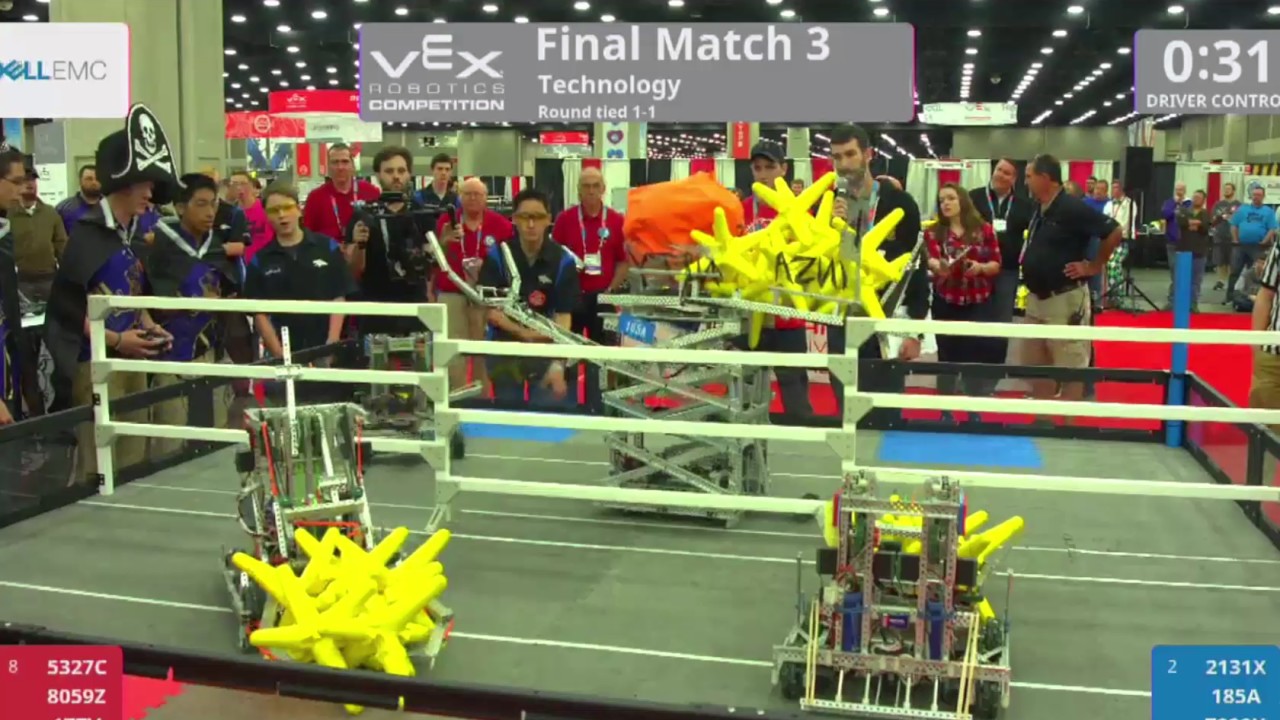

What about something like 185A in Starstruck with a big hopper and an arm? You could probably fit 4 mobile goals in the hopper and hold the last one in the arm and then balance on the bridge solo. Do you think something like this could work?
I do see a lot of potential problems, challenges, and issues with this design. It was just an idea I had, and I was wondering what other people thought about it and if it could actually maybe work?
Mobile goals are heavy. Don’t tip over.
The mobile goals weigh about twice as much as a cube, so I could see some potential problems lifting them. However, I think that something like that would probably be powered with pneumatics. You could probably also power it with the new stronger motors that we have now that weren’t available back in SS though, but I’d probably go with pneumatics.
You also wouldn’t have half of your hopper filled by scissor lift, so you could have a smaller hopper lower to the ground, meaning a lower CG. I doesn’t matter if the mobile goals tip over in the hopper, and if they are close to the ground, it should make your robot pretty hard to tip over.
