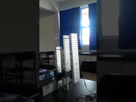

This is a test of our lift but is very low and it would not be able to the intake

Nice - cubes are pretty light, I would suggest making sure the whole structure is packed compactly together. The challenge then is to move cubes to goal area which has bumps around it.

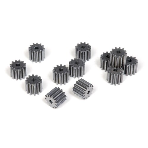

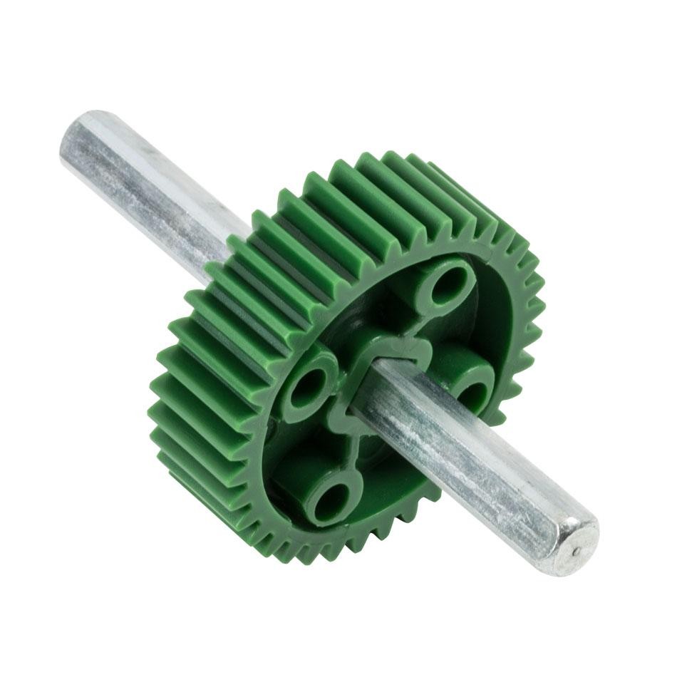

I’m using this gears
but I would like to know if they are better states for this type of elevator

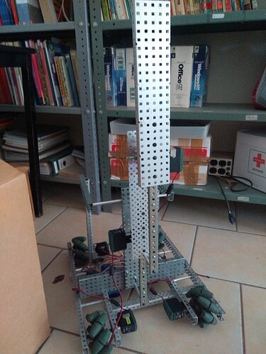

This is one pic of th prototype
Do you have chain for a cascade lift?
Yes, however I do not know how to do it I have little structure material
I’m pretty sure you don’t need much material for a cascade lift, though I might be mistaken.
Tengo solo 2 canales c de 25 hoyos si no es que solo uno ya que el de 35 hoyos es muy grande 17.5"
I have only 2 c channels of 25 holes if not only one since the 35 holes is very large 17.5 "
