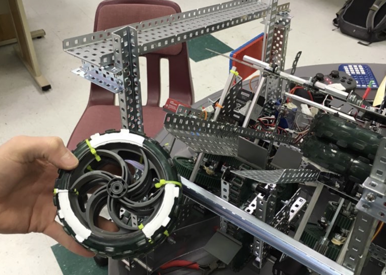

I want to construct a custom encoder using a line follower sensor and a disc of plastic sheet. Could I legally colour divisions into the disk with marker pen or would the ink be considered a non-vex part?
Could the ink be legal because of R7:a which allows any non-vex material strictly used as a color filter or a color marker for a VEX Light Sensor or does this rule only allow non-vex colour filters/markers for the 276-2158 Vex Light Sensor and not for the 276-2154 line follower sensor.
Yes, this would be legal, because of the rule you cited. My team implemented a similar system in NbN to get custom flywheel speed tracking:
It worked pretty well, though I would advise you to include as many distinct sections on the wheel as possible. A few weeks after taking this photo, we tripled the number of sections on our flywheel, which dramatically improved the resolution and performance of our tracking and control software.
