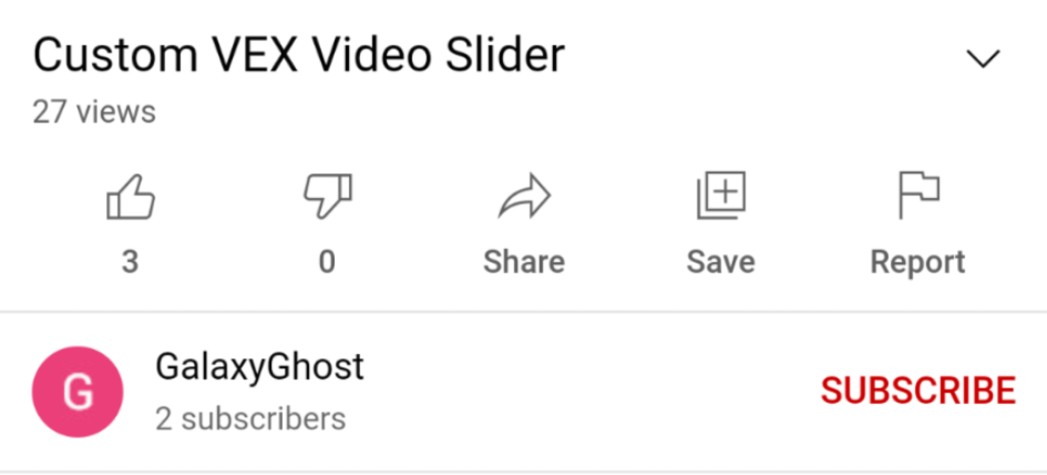

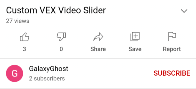

Who’s ready for GalaxyGhost 2: Electric Boogaloo?
Nice job :+1:… Great use of the old cortex system
Does this mean @hero1 was behind @GalaxyGhost?
Edit, for those not familiar: fun times
Thank you! Actually this project used the original legacy VEX 0.5 Microcontroller, which worked very well considering the results I have obtained in panoramic and 3D photogrammetry and 3D stereoscopic photos.
