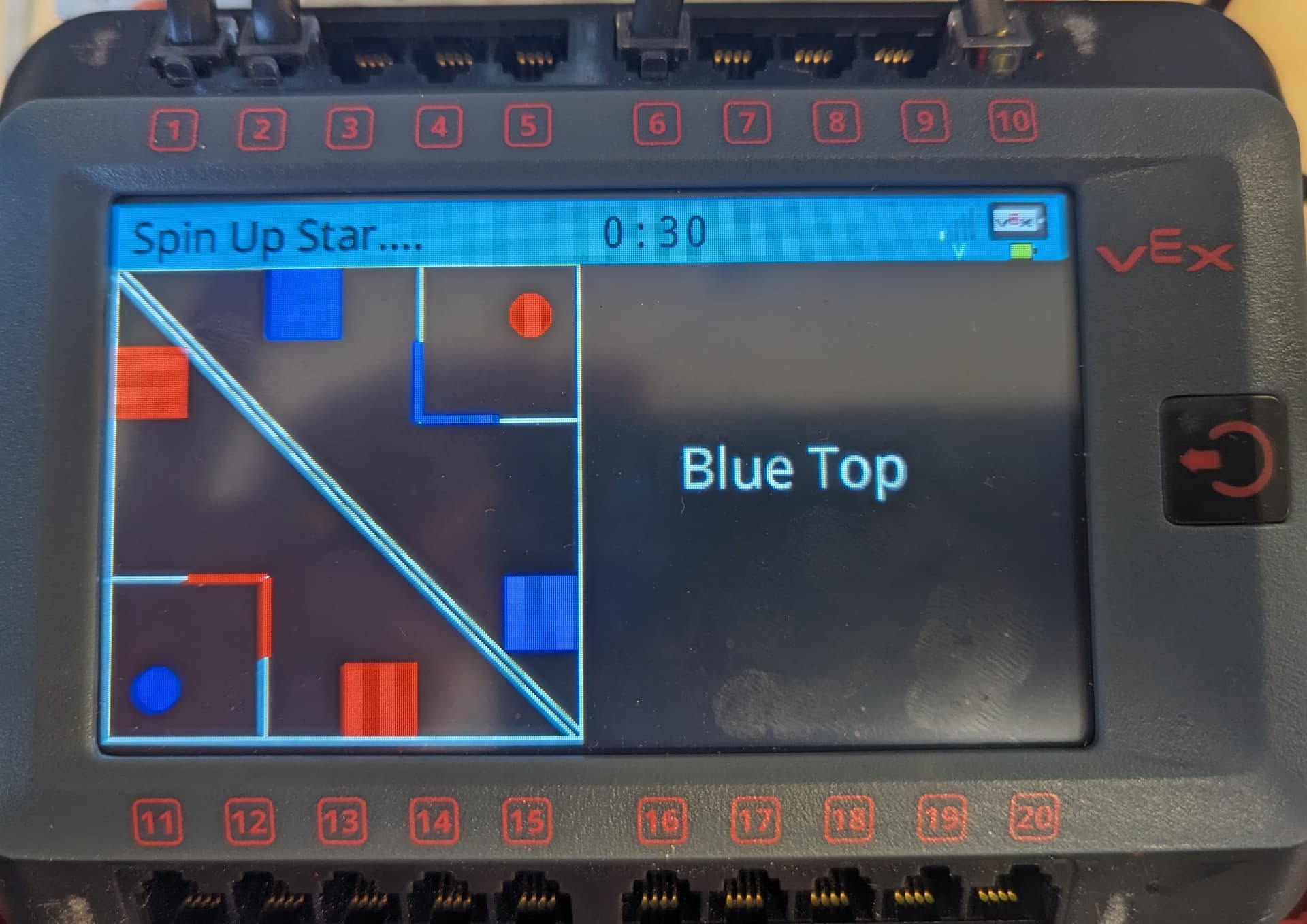

did something like that during turning point season - used touch screen to select features to use.
I put together a similar code last year to show my teams that it was an option and to encourage them to try it. It was a bit late, so no one followed through last year, but a couple are considering it this year. Only one team was text coding last year, so I did this in block code.
You simply press your starting area to select Auton routines… Text confirmation on the right of screen. It uses the “broadcast” block to activate the various routines.

Those examples are single program but with user selection via the V5 screen, that’s how we would expect different autonomous routines to be selected (or using other sensors as alternate to the screen).
What @Hudsonville_Robotics was suggesting (I think) was a single program on the brain that could be executed from any brain slot and then receive info about which slot is was executed from. In other words, one program that masqueraded as 8 different programs. That’s something we cannot do on V5 (or IQ2 and EXP) as it would require an approach to programs and the file system inside the V5 firmware that is extreemly different from what has been implemented.
