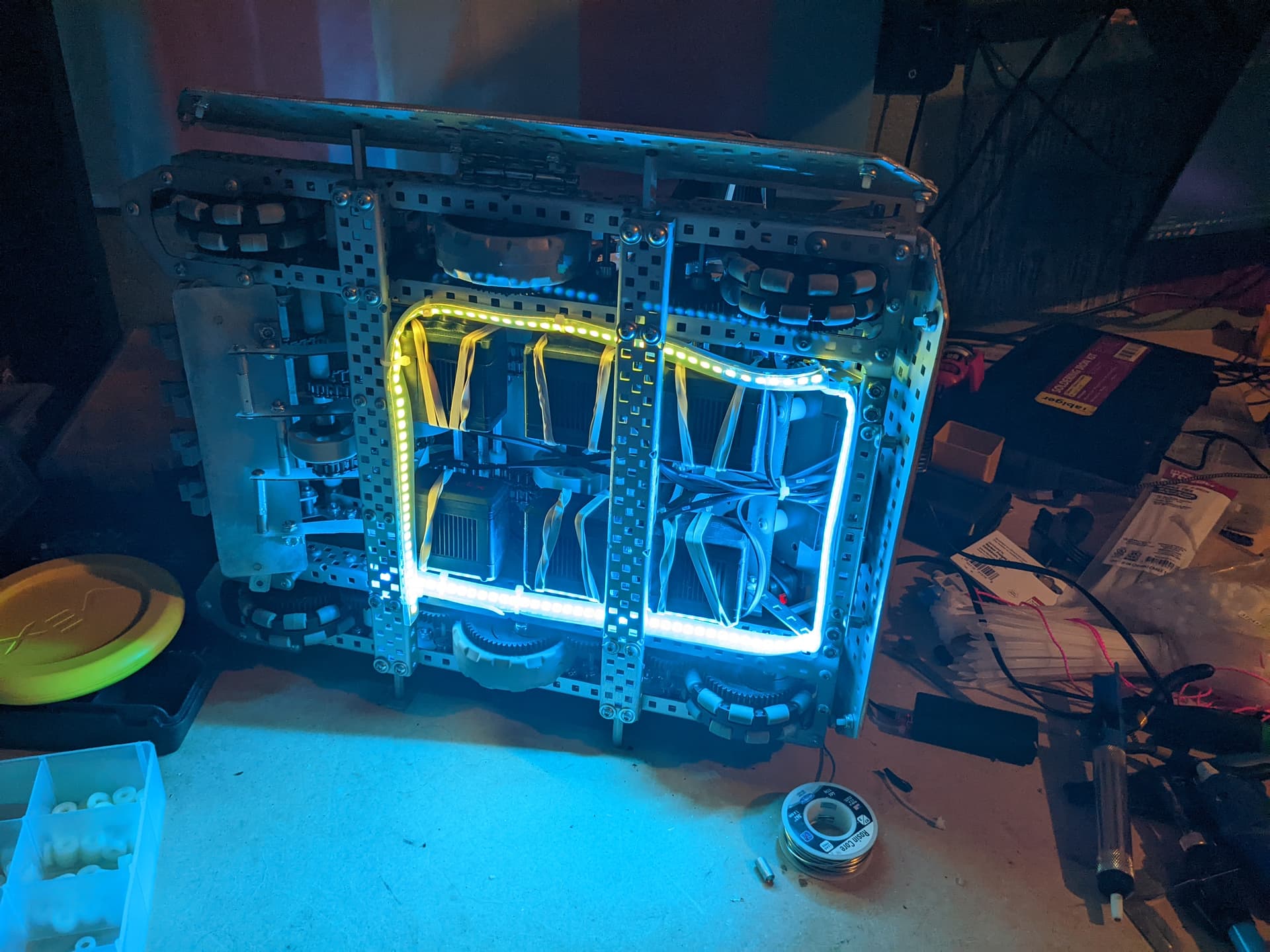

V5 Addressable LEDs
Gottem. Thanks @jpearman
Very impressive. Mind creating an explanation/tutorial?
And I assume that this is VRC legal as the rules are currently written?
Yes, these are legal as the rules are written. I don’t have any logic components between the brain and the light strip. The recent firmware update allows this to work. These def don’t warrant a full explanation, as they’re very simple, but basically i would suggest just getting one of these or something similar
Wire the power, ground, and data lines on the light strip to the power, data, and ground lines of a vex 3-pin connector, then plug it into the brain.
James has made a very helpful demo program here that I took and modified to get these colors working
I imagine PROS will support this in the coming weeks.
also im realizing now that at full brightness, the current limiting on the V5 will start to become an issue for my motors…

Whats the max current you can do for the strips? I see from a prior post that it counts against the overall current from the battery.
The ADI ports cap at 2 amps I believe.
I have been corrected that using lights like this won’t force the brain to limit current to motors, however it still does count against the overall 20A limit that the battery has in place (20A pulled from it for > 2 seconds = turn off battery for 10 mins)
This being said, 144 ws2812b at max power are supposed to pull 7.2 amps, so how this is working is beyond me.
In my experience with Adafruit Neopixels (same chip) they also tend to be waaaay below the stated max of 20ma per channel per led.

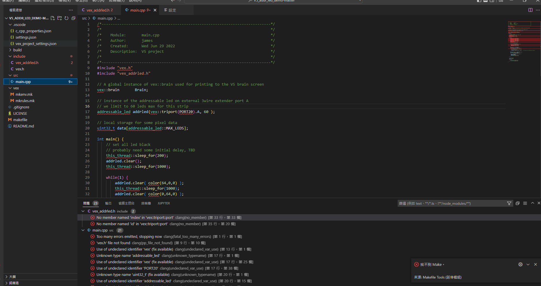

Why are there so many problems?
It can’t find make,and it can’t find “vex.h”
How can I solve it?
Those are just linter errors, disable the PROS extension and clangd and it should look fine.
It should still compile just fine like that, though.
thank you!
it’s clangd problem.
it’s working!
