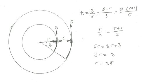

Can you explain how you arrived at this formula and what dLeftInch and dRightInch mean? I know it is from the Pilon’s document, but I didn’t understand how they did that because they didn’t really explain what ΔL and ΔR mean. They explained the rest of the variables, but not those two.
I would assume ΔL and ΔR are counts reported by the left and right side encoders.
To understand the formula you may want to look at this example:
We have a robot of width “l” that turns around some point which is “r” inches away from it. Let say over the time unit “t” left wheel encoder reports 3 counts (travel distance) and the right wheel reports 5.
If you know the width between the wheels then you can calculate both the unknown radius “r” and angle “theta”.
The movement of the robot is the sum of translation of center of the robot along some path and the rotation of the robot body around that point.
Special case would be when the robot only rotates around the point between its wheels.
Yeah. I figured out the math at one point, but I forget how I did it.
The math works out that (left-right)/width gives you angle of robot.
@technik3k’s explanation is good. Just a small correction, I think ΔL and ΔR means the delta in inches that both wheels have moved, converted from ticks (counts).
Just to clarify, d means delta, which means change from last iteration.
You first want to find the new encoder readings. Then, you want to convert that into a standard unit, such as Inch. What matters is that it is the same unit the chassis is measured with. Then, to find the delta wheel movement in inches, you substract the old encoder inch from the new encoder inch.
