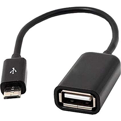

If you want a usb attachment (which is a good idea), I recommend a simple usb connector:
My team has a micro-USB to USB extension so that we can plug a cable directly into the USB instead of puling out and putting in a cable to the micro-USB. We just keep it plugged in at all times and it is covered by a little C channel to keep it from moving.
