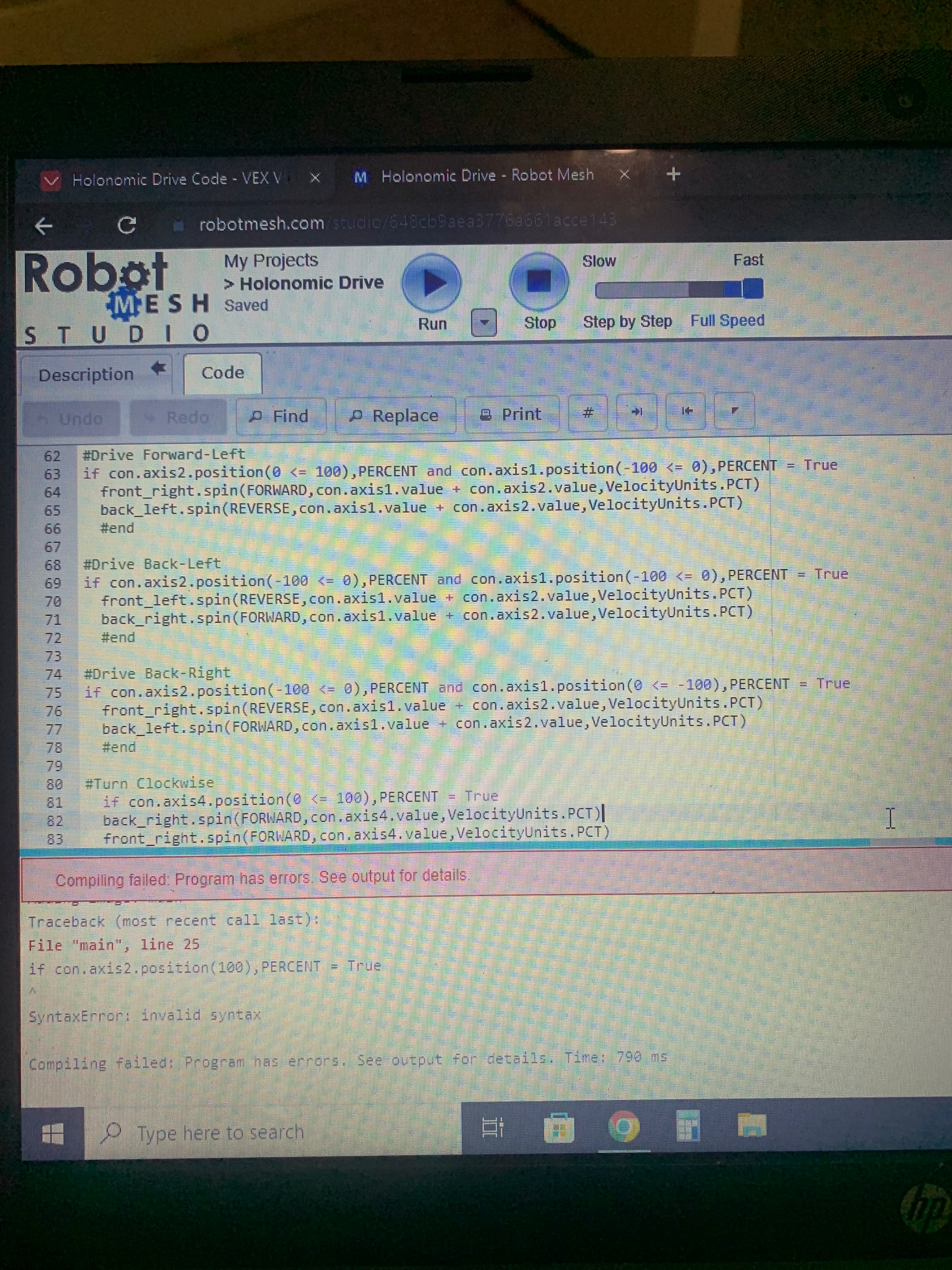

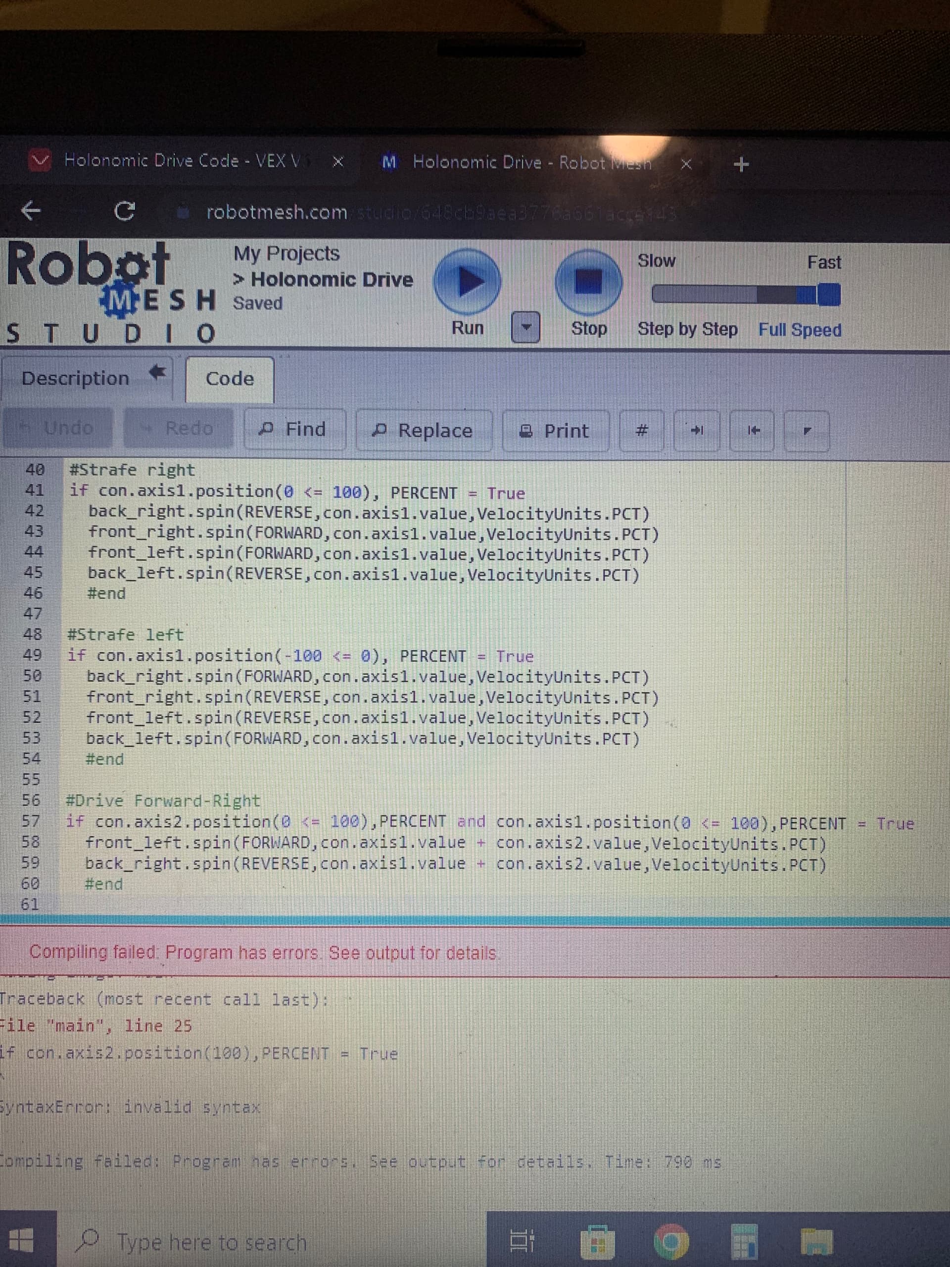

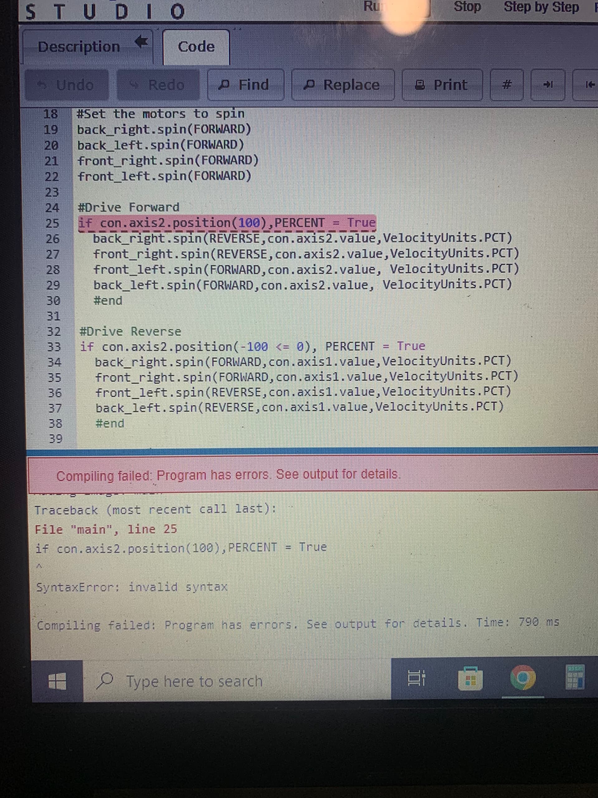

Hi! So I’m extremely new to Python coding, but I’m trying to program my V5 robot controls via python. I’m using a website (is it an interpreter? Idk, like i said really new) called RobotMesh Studio since it already has all the V5 stuff imported and I don’t have something I can get VEXCode Pro on. I’m getting a syntax error when I try to run my code, and I was hoping for any pointers on what I’m doing wrong, how to fix it, what I should do moving forward and yeah, like i said I’m really new to this. I’ll go ahead and attach my entire code below since y know I’m sure that’ll be useful.

I see what you are doing, for your if statements, you currently have them as
if con.axis2.position(100),Percent = True
Python evaluates if something is true, so we don’t want to use this equals true. (For other times we use equal signs, 1 equals sign sets a value, and 2 is comparing, as a general rule.) So alright, we now have this for our statement.
Python uses words for and’s and not’s, so if we wanted the controller axis 2 position to be 100, and Percent to be true, we could simply spell it out.
if con.axis2.position(100) and Percent
Now there is one last thing, we are missing a semicolon at the end, so our final if statement will look like
if con.axis2.position(100) and Percent:
