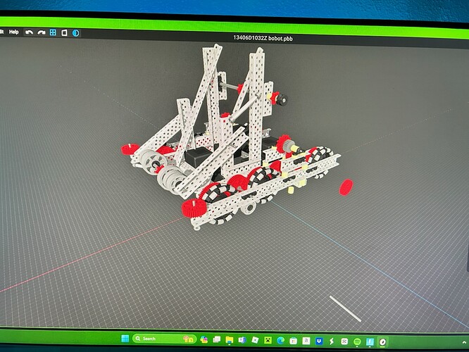

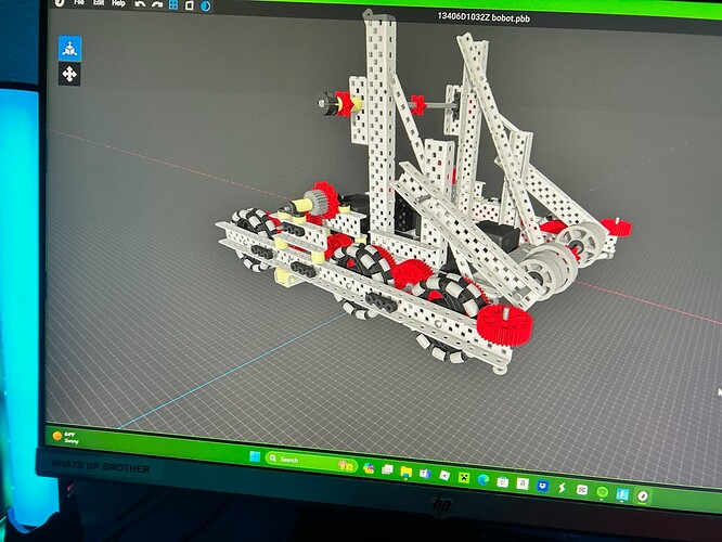

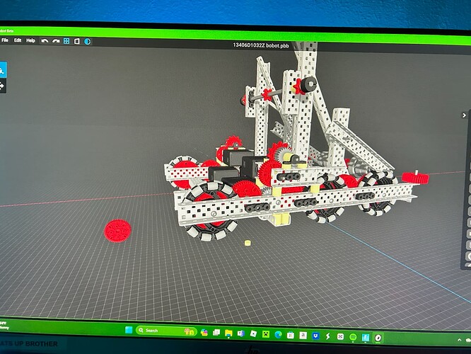

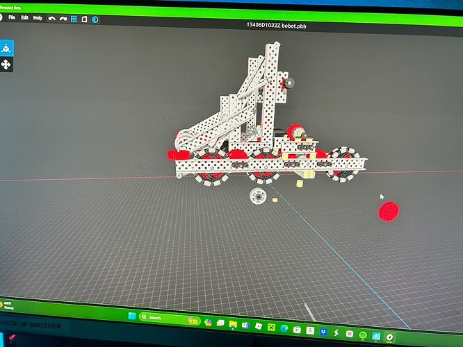

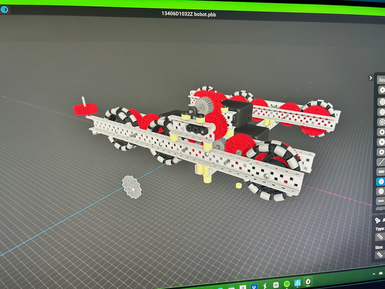

Here is my team’s cad so far.

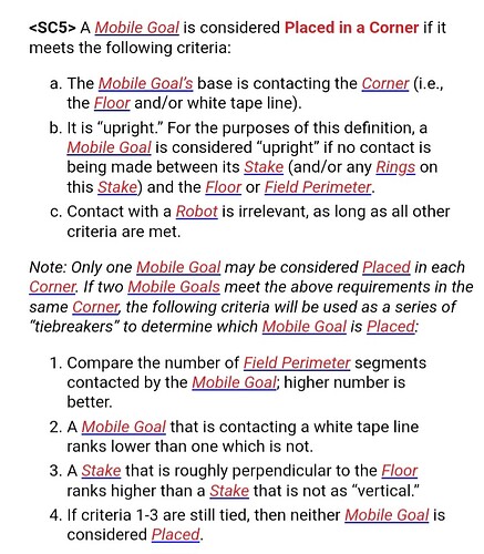

I was reading the rule book and it says that the stake has to only be touching the tape line of the positive and negative corner so does this mean
I can put 2 goals in the same corner both touching the tapeline?
Thanks!
Would it be legal to have one mobile goal in the robots possession while also scoring a stationary mobile goal while i.e. when pushing it?
Thanks
Read <SC5> Note carefully:
Note: Only one Mobile Goal may be considered Placed in each Corner. If two Mobile Goals meet the above requirements in the same Corner, the following criteria will be used as a series
of “tiebreakers” to determine which Mobile Goal is Placed:
Hope that helps clarify that only one counts as Placed.
No, please refer back to SC5.
I believe the rules say only 1 goal can considered in the corner. They have a list of “tiebreakers “ to decide the more in goal. If it can’t be decided, neither goal is in corner and neither gets the bonus

Less images and more description would also be better imo.

Oh, sorry, I’ll add a description later
Personally, I recommend switching to Onshape for CAD. I did and I think that it’s much better than Protobot. Your CAD looks good though!
I am just starting out with cad, so I am not very experienced and protobot is just nice for beginners.
Onshape provides resources for beginners. This link helped a lot when I was learning cad.
