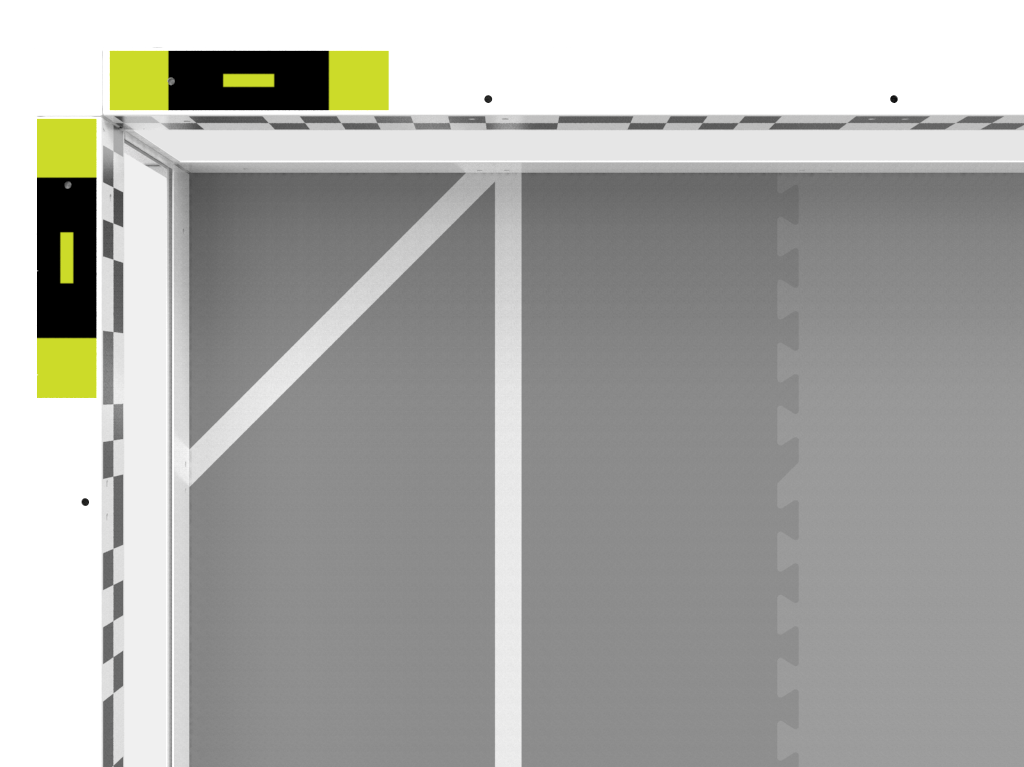

  1. Changed the Field layout such that Positive Corners and Negative Corners are now on the same side of the Field, rather than cater cornered
  1. Updated Figures throughout the manual to display the new Corner layout

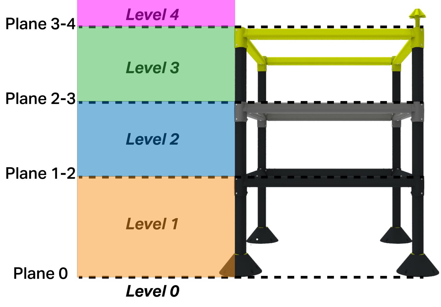

  2. Added a new definition of “Plane”
An imaginary horizontal surface that divides the vertical space between two Levels, and expands infinitely across the Field

  1. Updated Figures SC7-1 and SG3-1 to show Planes
  2. Updated SC7di to clarify intent
Each Level corresponds to a vertical section of the Ladder. For example,
a Level 1 Climb represents a Robot whose lowest point is above the Floor tiles, but not higher than the black rung of the Ladder.

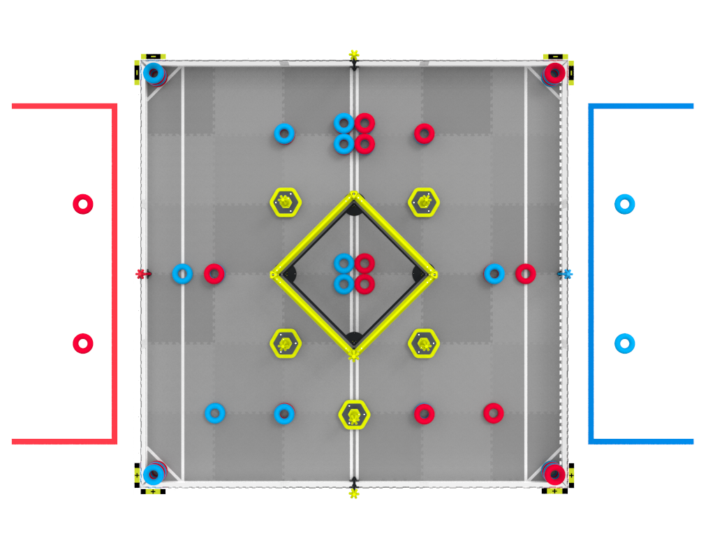

  1. Changed the Field tape layout so that Corners are now triangular
  2. Changed the starting Ring configuration; the Ring stacks that begin in the right Corner along each Alliance Station wall have been flipped
  3. Added Figure FO-3, to show the recommended locations of referees, and the field monitor
  4. Rewrote the definition of Corner to account for the new tape layout

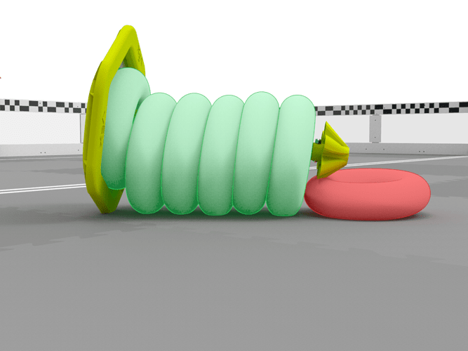

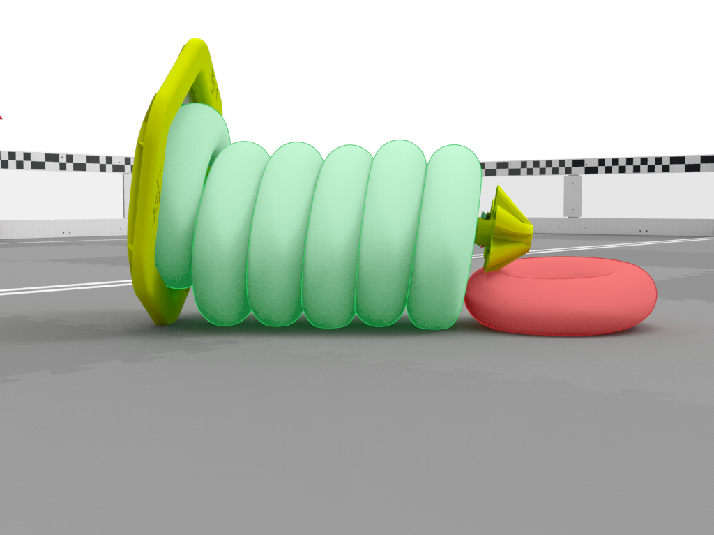

  3. Rewrote SC3 and updated its figures so that Rings can still be Scored while in contact with a foam tile or a Robot of the same color
There is no requirement for a Mobile Goal to be upright in order for its Rings to be considered Scored. Contact with any other Field Elements or Rings is irrelevant.

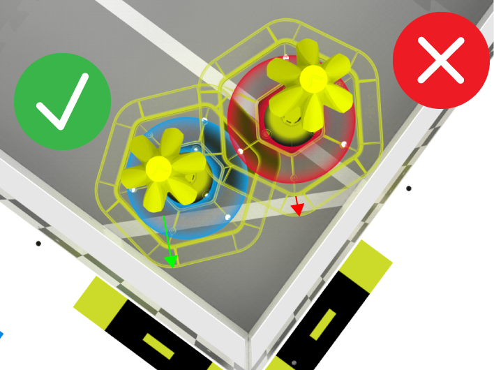

  1. Rewrote SC5 to provide new criteria for Placed Mobile Goals, and tiebreakers if more than one Mobile Goal ends a Match in the Corner
Placed Mobile Goal Criteria
a. The Mobile Goal base is contacting the Floor or a white tape line.
b. Some portion of the flexible top of the Mobile Goal’s Stake is higher than the top edge of the Field Perimeter.
c. The Mobile Goal base is breaking the plane of the Corner.
Tiebreakers
  1. The Mobile Goal whose base extends farthest into the Corner is Placed. See Figure SC5-1.
  2. The Mobile Goal whose Stake is most vertical (perpendicular to the Floor) is Placed.
  3. The Mobile Goal whose flexible top extends farthest into the Corner is Placed.
  4. If multiple Mobile Goals are still tied for the above criteria, then no Mobile Goal is considered Placed in this Corner."
