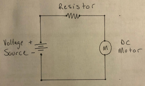

Question: How Does Load Resistance Impact the Power Output of a DC Motor?
Independent Variable: The load resistance of the circuit.
Dependent Variable: The time it will take for a winch to lift a weighted string over a certain distance.
Procedure:
1. In my experiment, I will have a fixed resistor of a certain resistance in series with the winch system that is powered by a single DC motor. This winch system is connected to a weight of a specific mass by a string.
2. Using Ohm’s Law as well as the resistance value of the resistor I am using, I will be able to calculate the theoretical value of power that the motor will exert.
3. I will turn on the circuit and measure with a stopwatch how long it will take the winch to lift the weighted mass. Using the equation W=Fd, I will calculate the Work that was performed by the winch. Then, using the equation P=W/t, I will calculate the experimental value of power that the motor had exerted.
4. I will perform step 3 (or more) times to reduce error.
5. Then, I will replace the resistor I used with one of greater resistance, and repeat steps 2-4.

All components will be placed in series with a voltage source that emits a constant voltage, regardless of the load resistance.

It’s possible that I am simply misunderstanding the experiment you intend to conduct, but I get the impression that you may be misunderstanding some electrical principles. Let me explain.
You provide this circuit schematic:
This is not wrong by any means, but do you know what a simple DC motor can be modeled by? Nothing more than a resistor:
Note, though, that the equivalent resistance R_M of the motor will vary based on the motor’s mechanical load and potentially also based on other factors like voltage V_M across the motor (not to be confused with V_S).

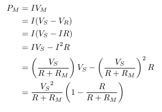

In your step 2, you say you will calculate the theoretical power P_M the motor will draw, using nothing more than Ohm’s Law (V=IR) and P = IV. I recommend you try and work out the algebra for that, and see what you find :slightly_smiling_face:
Don’t forget:
  • Both of these relations only work for individual circuit components, not complete circuits.
  • It is possible to simplify circuits (i.e. combine circuit components) using the rules of series and parallel resistors.
Expand to see the algebra worked out (try it yourself first though!) and conclusion
(Sorry that MathJax doesn’t work inside these Hide Details blocks)
Remember the goal here is to find P_M in terms of known quantities only, i.e. V_S and R:
You can see that P_M is stuck dependent on R_M — an unknown (and even potentially variable) quantity. So there is no way to theoretically determine P_M in your setup; it can only be found experimentally.

Wow, everything here is so helpful! It’s true, I’m not the most experienced in electricity. As a Junior in high school, the only class I’ve ever taken on electricity was a dual enrollment class at our local county college. I am enrolled in the PLTW curriculum in my high school and I will be taking Digital Electronics from this February to June. Despite my lack of expertise I’ve always had an interest in electricity, so I’ve chosen this particular topic as a means of learning more about it myself. I’m open to any advice you may have.
Regarding not being able to measure R_M – I looked it up on Google, and it states that the resistance of a VEX 393 motor is 1.5 Ohms. Would it be possible for me to measure the resistance of the motor myself with an ohmmeter? Also, how could the resistance of the motor change? I’m guessing this has something to do with inductance, but I’m not too sure.

So, as long as the voltage stays the same, the power in the motor will increase as the current in the motor increases, correct? (P=VA)
Regarding the resistance of the motor, and this is a very simplified version of how a motor works, at the same voltage, with the more load you put on a motor (that is to say, the harder it’s working) the lower the resistance is.
From the 393 info sheet from VEX, at 7.2V there are two values listed, the free current and stall current. Free current is the amount of current drawn when there is no load on the motor (it’s spinning freely), stall current is the amount of current drawn when the motor is unable to move because it’ can’t overcome whatever is opposing its movement (it has stalled). Those two values are 0.37 for free current and 4.8 amps for stall current respectively.
Using Ohm’s law, at 7.2V on the motor, the effective resistance when free spinning is about 20 ohms, and the effective resistance when stalled is 1.5 ohms, the value you found.
I get that it’s counterintuitive that resistance is lower when something is, you know, resisting movement of the motor. I tried to come up with a metaphor or something to explain it and came up blank there, sorry.

You are on the right track here. R_M is NOT the motor coil resistance, which you can measure with an ohmmeter (and should be 1.5 Ω). R_M is not a real resistance but rather just a stand-in representation for V_M/I.
Inductance and magnetism do play a part if you want to really analyze the theory and get a fully theoretical P_M. However, you can still do a lot with just Ohm’s Law as long as you are mindful of quantities you can only determine experimentally.
Very good questions!
Well…yes… but you don’t get to control the current. One of the simplest, but hardest, concepts in electronics to explain is that Ohm’s law rules everything. If you hold the voltage constant, the current will be based on the “resistance” that the motor has…but for motors it really isn’t resistance (at least not exactly like a resistor) because we’re dealing with a inductive (a magnetic coil of wire) based system.
Back to the motor: it will draw more and more current as the load increases on the motor, to the theoretical point of “infinite current” when it stalls, but physically that’s not possible.
