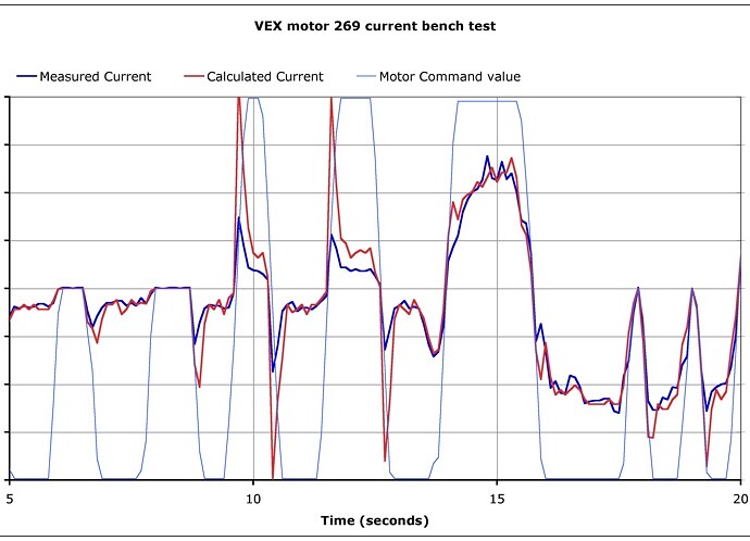

The test code calculates current for the monitored motor and also samples actual current 10 times per second. Sampling more often would give smoother data but 10Hz is the speed I plan on running the code in the final software so seems reasonable. Data is sent to the debug stream and then copied to excel for processing. The first test done was with a 269 motor on the bench driven from port 10 on the cortex. A couple of issues came up, I’m not going to go into great detail but the first involves a situation where the motor command value is changing from negative to positive and the motor speed is still negative. The current calculation was creating a transient current spike that did not exist in reality. The code was modified to use actual motor direction rather than command motor direction for low values of motor commands. The second issue relates to the setting of the free running speed of the motor, this seems to be a critical parameter, if it was too low and actual speed rises above it then back emf is to high resulting in inaccurate calculations. Anyway, another modification to the code to address that. This graph shows the result of the bench test of the 269 motor, the x axis is time, the y axis current. The light blue trace gives an idea of what the command value was for reference.
As this motor was just loose on the bench there is not a lot of load on it, you can see where I slowed it down at around 15 seconds. Not a bad match so next I installed the current monitor onto a 393 motor driving one wheel on a mecanum wheeled chassis I have.

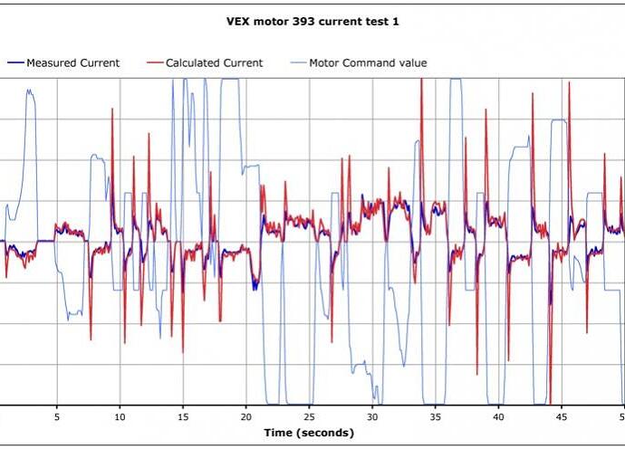

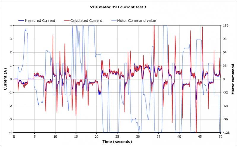

The 393 motor was on port 9 and being driven by a motor controller 29, the first test did not give a very good match between calculated and measured currents, the model was adjusted using a visual basic version of the algorithm in an excel spreadsheet. The free running current was reduced from the models default 370mA to 200mA and the free speed set to 110rpm, here are some results (it was a “reversed” motor so command values are opposite to the motor current ).
Normal driving (it’s a very light robot so not much strain on the motors)

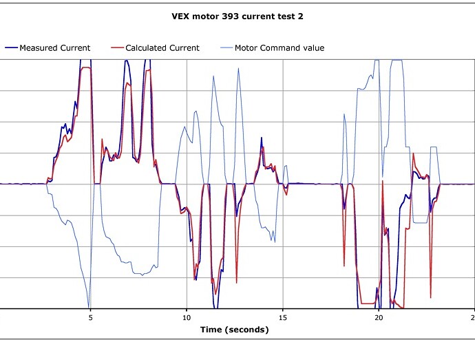

Stalling the motor by holding the wheel.
So my conclusion is that the model works, at least to the level of accuracy we need for the PTC monitor. There are some differences but these could be explained by the slow sample rate being used probably missing some current transients. The model is most sensitive to the value we are using for free speed, it could be improved by using a different value for forwards and reverse. Ideally parameters would be tuned for each individual motor but life is too short for that.
