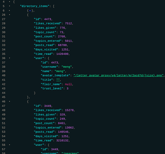

Two months later, I ran into APIs again. I googled it, and after a week or two of playing with APIs, I figured I should try the VEX API. I wrote a short script attached to a Google Sheet to fetch

  var search = 'https://www.vexforum.com/directory_items.json?period='+period+'&order='+order+'&page='

“https://www.vexforum.com/directory_items.json?period=all&order=days_visited&page={number from 0 to 40}”
I installed JSON Viewer on the suggestion of @Noah10851B in a really old topic and when I visited that, I saw
I ran the script to pull that page, reformat it into a 2D array, and paste it into the spreadsheet, over and over... a hundred times.

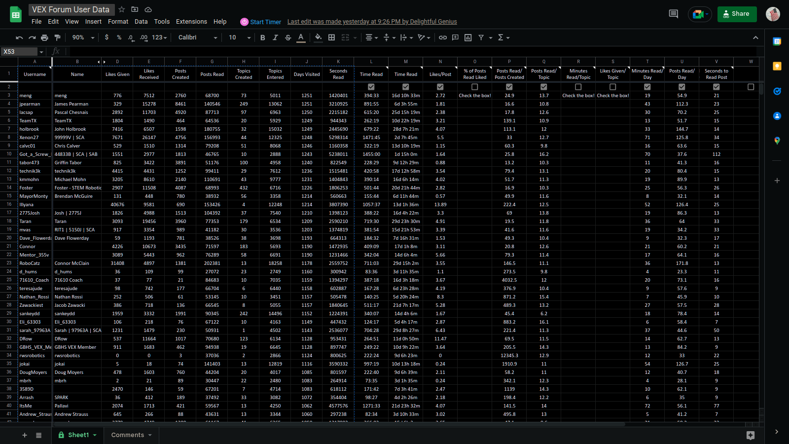

Then I added a bunch of columns to calculate ratios, averages, times, and anything else I could think of.
So now I present to you…
VEX_Forum_User_Data
(Click it!)
I added a “Comments” tab you can see on the bottom, so if you have any comments, questions, or suggestions, add them there or PM me.
Have fun!

If you do something and all the formula columns slowly disappear, check or uncheck a box and they should come back after a bit.
I sorted by average likes per post:
Username Name User ID Likes Given Likes Received Posts Created Posts Read Topics Created Topics Entered Days Visited Seconds Read Time Read Time Read Likes/Post % of Posts Read Liked Posts Read/ Posts Created Posts Read/ Topic Minutes Read/Topic Likes Given/ Topic Minutes Read/ Day Posts Read/ Day Seconds to Read Post
