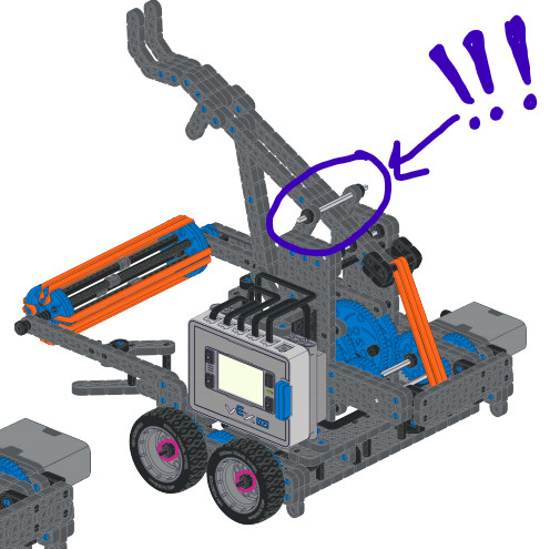

Hello, team 1715S here with more catapult issues. As you will see in the video below, the beams holding our catapult fly off when the catapult shoots. We can’t lower the power as that power is just enough to send the ball into the pitch. Does anyone have any thoughts on how to fix this? By the way, thanks to @JcbMrgn and @u89djt for helping fix our former issues.

While we’re waiting for the video, I suggest looking at your other pivot options like shafts, and maybe consider building together everything that rotates in sync.

I would try attaching a shaft through both gears.

bruh. one of the main issues is that u have WAYYYYYYYYYYY TOOOOO MANY RUBBER BANDS. Like too much. Like way too many
I would reccomend using less rubber bands, positioning them BELOW the edge of the catapult, and use less speed in the gears for the catapult. There is too much g-force/acceleration for the pins to handle both the rubber bands and centripidal force, so you should try to solve the force changes on the pins. also, capped pins will help.
Well as I have many experiences with these type of problem, first I will recommend putting two balls on your catapult to see if that will work. If it does not then add stronger pins.
The best solution would be to attach the catapult assembly to the gears using axles.

Well, Brandon, if I have to identify a problem… I’d say the catapult is too strong for the pins on the choo-choo mechanism. But I can’t make the catapult any weaker, because it just now is barely making it into the goal. How can I redesign my robot without removing rubber bands?
Perfect! Let’s see then. So would you say the force of your catapult obviously too much for the pins?
I guess so. I could just replace the pins with a stronger option? Like a standoff or an axle?
Maybe! That’s a good idea, but let’s say hypothetically that we could make the pins super strong! Like so strong they wouldn’t break. What would be the next thing to fail?
The gear is still moving, so maybe the gear? Or maybe the links themselves would break? The links are only held on with pins too…
Great points! So how do we take the force off of all the moving parts? Does the catapult break itself when you catch the catapult before the end of it’s travel?
No! It doesn’t blow up if I stop it before the end of it’s travel! That’s so weird. I wonder if I could build a structure that would be really super strong and rigid that would stop the catapult before all of the linkage parts get completely stretched out.
That, my friend, is called a hard stop. You could totally do that. In fact, the hero robot Fling that VEX released has that exact mechanism at the top of it to do exactly what you are looking to do. The hard stop reacts against the actual catapult arm and takes all shock loading away from the linkage and puts it into the structure and the catapult arm.
