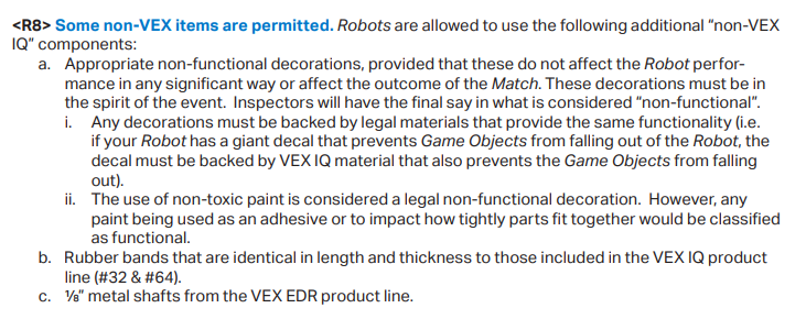

If youa re at a tournament, simply show them < R8 > and note b. Only the length and thickness is important.

That’s the vex IQ manual, but there is an equivalent statement in the tower takeover manual.

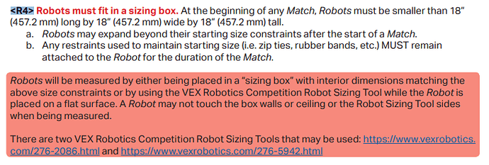

<R4>
< R4 > does not say that rubber bands that aren’t vex can be used.
You’re right that my post was for IQ. I can’t find the equivalent rule for VRC. The phrase for rubber band can only be found here in < R4 >.

So part d there is different from the IQ rule… It has to be materially the same as the VEX product. The IQ rule is only for size, not material… interesting…
