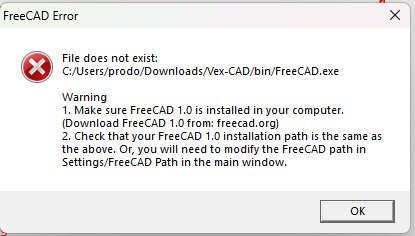

I’m having trouble using it, I don’t understand what its asking me.
See this, install FreeCAD

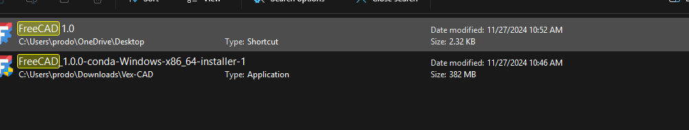

I have FreeCAD installed
If FreeCAD is not installed in “C:\Program Files\FreeCAD 1.0”,you need to manually update the FreeCAD Path in “Settings->FreeCAD Path” to ensure VEX STEPmaker works properly.
You can refer to this guide for details.
