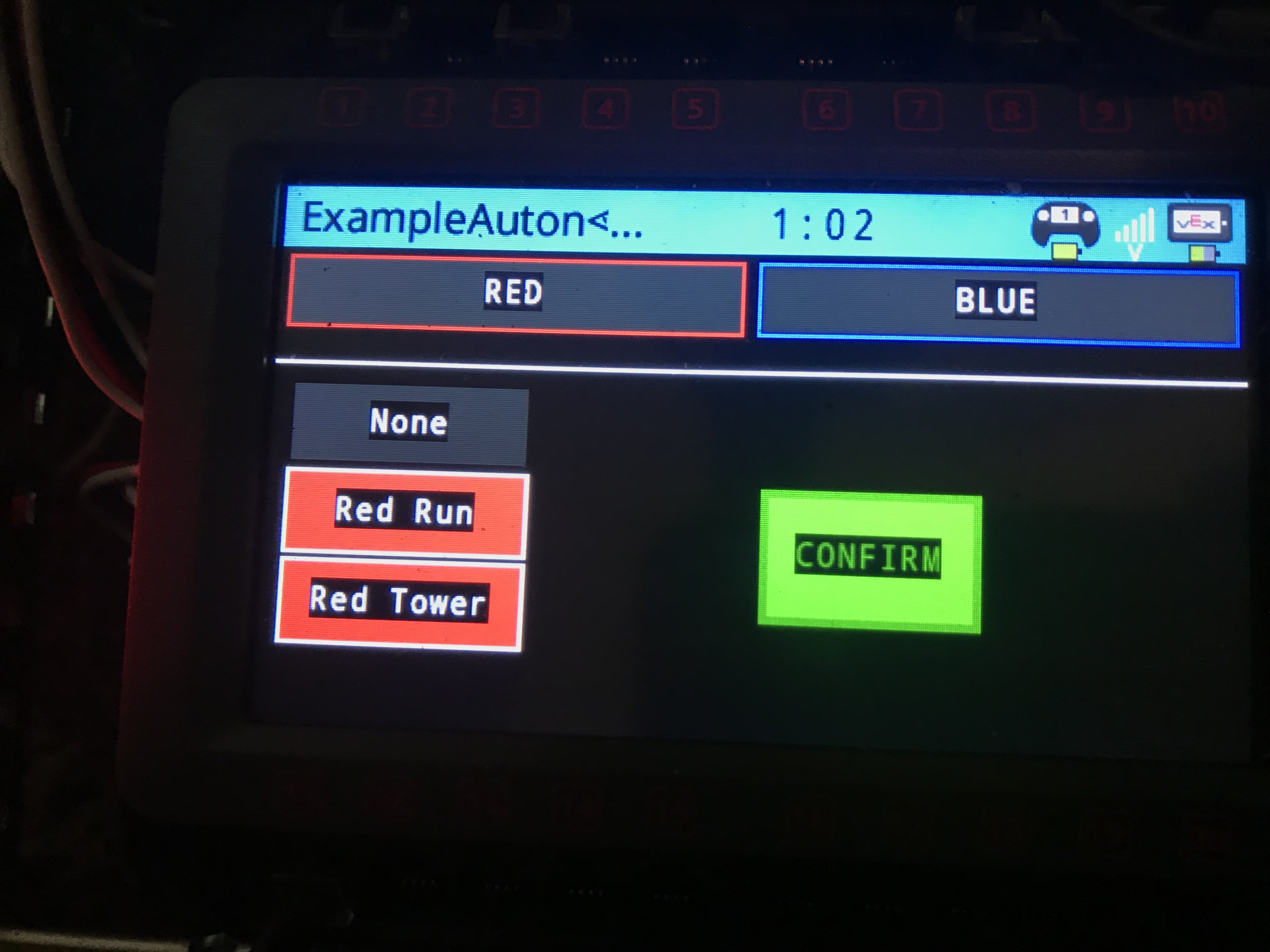

The class can turn a single line into a button with a specified color, outline, text, font, text color, and more. To show an example of what it can do, I spent ~15 minutes coming up with the following code:
lcdButton redButton(120, 22, 230, 35, "RED", "#252525","#FF2525",2);
lcdButton blueButton(480-120, 22, 230, 35, "BLUE", "#252525", "#2525FF", 2);
lcdButton confirm(300,150,100,60, "CONFIRM","#14c40e", "#0f990b", 4);
lcdButton none(xplace,90,120,40, "None", "#252525");
lcdButton redrun(xplace,135,120,40, "Red Run", "#FF2525", "#FFFFFF", 2);//, color(255, 33, 33));
lcdButton red4(xplace,180,120,40, "Red Tower", "#FF2525", "#FFFFFF", 2);//, color(255, 33, 33));
lcdButton bluerun(1000,135,120,40, "Blue Run", "#2525FF", "#FFFFFF", 2);
lcdButton blue4(1000,180,120,40, "Blue Tower", "#2525FF", "#FFFFFF", 2);
These 8 lines of code generates the following:
If this quick example isn’t aesthetically pleasing enough, that’s okay because all you’d need to do to fix it is change one or two parameters. You don’t need to rewrite the entire rectangle drawing and hit detection code.

Hey, it’s been a little while since you’ve posted this but what is the xplace for? I just found this and its giving me an error for xplace
xplace is a variable only in the example auton selection, it isn’t part of the library itself. In the example it is the x value that I used to line up the three options. If you increased xplace those buttons would move further right. I’m not sure why it would be giving you an error unless you changed the location of the buttons in the example.
I’ve been messing around with your code and I was trying to add code to the button so that it would run an autonomous but I couldn’t figure it out. Like if you pressed Red Run it would do a specific auton. Any advice?
It already does that. In the example I used the variable ‘aselection’ which was set to an integer corresponding to the last button press. With that you can do something like what I did in this year’s source:
