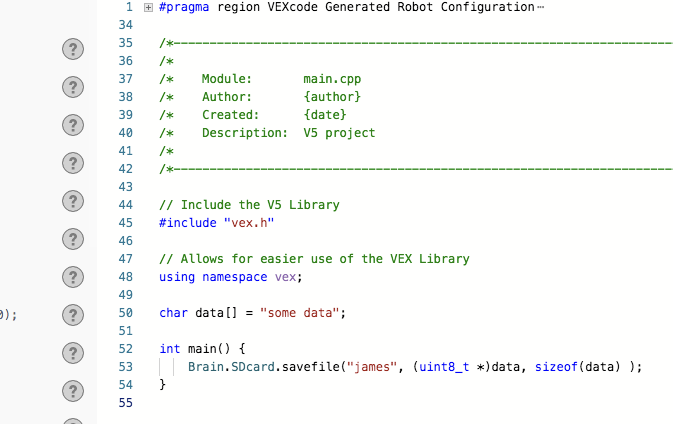

I am frustrated by the elimination of the SD Card access that is supported in VexCode Pro, but not in the standard VexCode. Use of the SD card to store parameters and measurements observed during a test execution can provide extremely valuable information regarding the conditions exsting in the robot during the test. The loss of this capability from the pre-VexCode distributions is painful. Ideally this functionality could be provided in VexCode Block/Text. Alternatively, is there a hook or wrapper that would allow VexCode V5 Block/Text programs to access the functionality of the API of VexCode V5 Pro?
The text API is the same for VEXcode V5 and VEXcode V5 Pro. Nothing has been removed.
you can also use stdio functions if you want to

Python is different, IIRC you would use brain.sdcard.is_inserted()
not everything has auto-complete, only the most commonly used functions.
Python and C++ are completely separate, but almost all C++ classes have a Python equivalent (using Python style). The easiest way to learn and play with the Python API is to use Python REPL (probably need to close VEXcode these days to access that).

sigh, that’s a linter error, you could “download anyway” or add indication to pylint to ignore the error message. @jpalnick seems like my stubs have that, something we need to check.
# Begin project code
# pylint: disable=maybe-no-member
