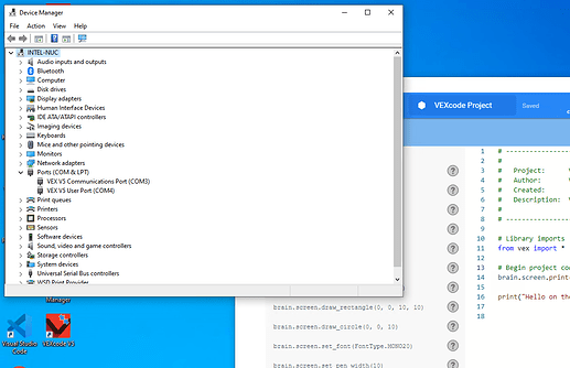

To use PuTTY you need to know which serial COM port the V5 is using (all this assumes direct USB connection, it does not work wirelessly via the controller although BLE support is possible), open up device manager and check the ports category.
The V5 is using COM3 and COM4, the one we are interested in is COM4, the “VEX V5 User Port”.

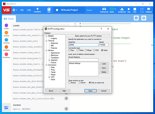

Launch PuTTY, select the serial radio button, enter the COM port and set baud rate to 115200 (although that probably doesn’t matter).

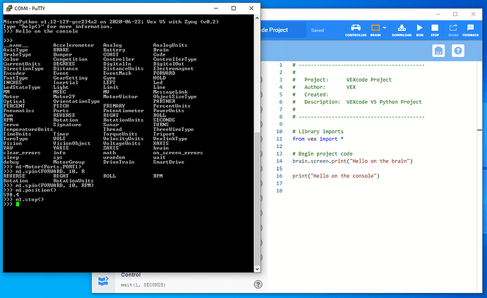

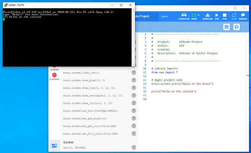

Write a small Python program in VEXcode, download and run, you will see the Python banner and anything you send to the console using the print command.
You can now interact with Python just as if you were writing a program in VEXcode, however, these are temporary commands and any devices or variables you create will be lost when the V5 brain runs another program or is turned off.
Hitting tab will show a list of currently know commands and objects.
There’s quite a lot as we import everything from the vex module for convenience.
now you could create a motor instance.
m1=Motor(Ports.PORT1)
ask the motor to spin
m1.spin(FORWARD, 10, RPM)
if at any point during entry you forget what the command is you can hit tab, it will show current options.
perhaps ask for motor position
m1.position()
and then send stop
m1.stop()
Here are what those commands look like in PuTTY.
This is a great way to experiment with commands and learn what’s possible, if you have a Python program on the V5 there’s even no need to fire up VEXcode to just play with the REPL, just run the program with PuTTY connected.

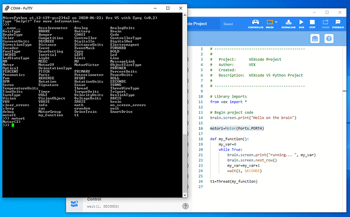

Are global variables declared in the running program accessible from the REPL? For example, if I write and run a python program that just declares a bunch of motors, and then access the REPL in putty/screen, can I drive those motors without needing to re-declare them in the REPL?
Lastly, are there any plans to add python support to VEXcode V5 pro?
yes, VEXcode will add some small boiler plate code at the beginning, but basically the code you see is the code that is executed.
The only issue is that you would need a special terminal program like the one we have built into VEXcode V5 Pro that understands how to demultiplex the output from the user code when sent over vexnet. The controller has a single USB serial port that is shared between admin (ie. download etc.) messages and stdio from user programs. Direct USB uses separate serial ports as does the BLE connection.
yes, anything declared in the user program is available, variables, functions, any other object.
yes, for example. in the program below I declared a motor, a thread and have a function.
when I hit tab in the REPL, you can see those objects. I asked for the value of “motor1” and it shows some basic information (class and port)
