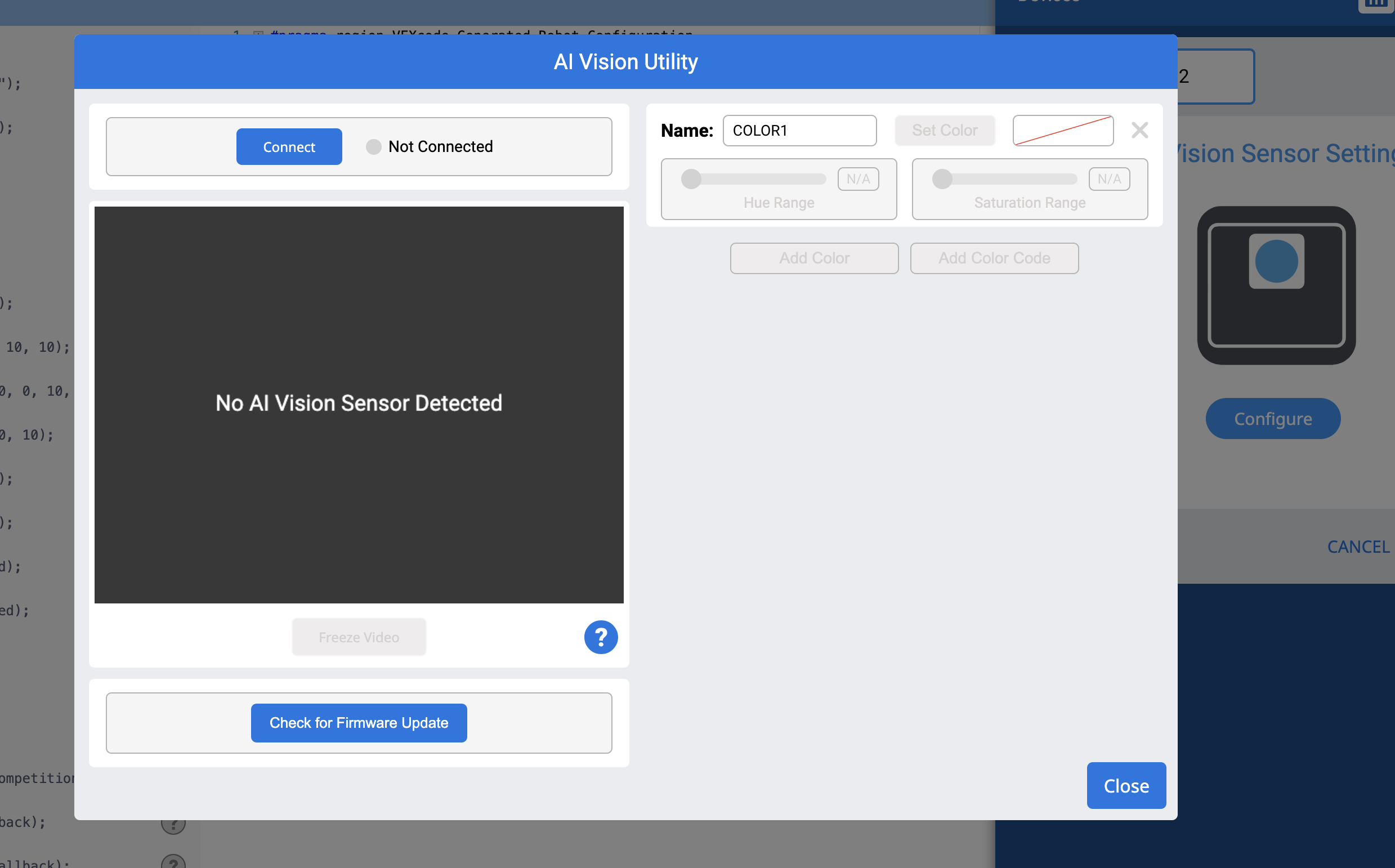

We have two (non-AI) vision sensors that worked previously. We’ve been trying to configure them again, but neither is now recognized by the Configure utility. (Connected to a laptop using codev5.vex.com.) No image is displayed by the utility.
When the sensor is connected to a brain using a smart cable, the brain does display signal, so I’m confident the sensor itself is still operational. This is true for both sensors.
I saw a mention somewhere (don’t recall if it was the forum or the knowledge base) that the sensor firmware could be updated by holding down the button while plugging in the USB cable, so we tried that, but that made no difference. Nor do I see a way to read out the sensor firmware version.

codev5.vex,com has minimal implementation of the vision utility that does not show streaming images, did you press the capture button top left ?
Yes, I saw the age and noticed that the thread wasn’t closed after a year of inactivity as is the norm (which suggested it was still fair to post). And the response said the new post would float the thread back to the top. Anyway …
Yes, we did. It reported there was no device found.

What PC (Mac, chromebook, windows) are you using ? I forget, but a driver may be needed under windows. To be honest I didn’t even realize we had released the web version, I’ll check and see if windows needs a driver next week, unless @rbalasub knows.

Follow-up from testing today:
The vision sensor calibration worked on a Mac.
The vision sensor calibration did not work on Windows (neither local VEXcode nor codev5.vex.com), not even in freeze frame, not even with a powered USB 2.0 hub. (Notably, it did work a couple of years ago on some older Windows laptops and an older VEXcode version.)
Does it show in the windows device manager ?
Windows does need drivers for the vision sensor, VEXcode should have installed those, but I believe the ones here may work also.
