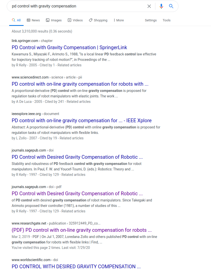

This is totally a common thing in real systems. It is called Gravity Compensation. On simple glance I only see research papers explaining it, I will see if I can find some more approachable resources. But you are totally correct in everything you said. PID/PD only handles linear systems, up and down being equivalent is one of the the properties of linear systems.
PD just happens to be so robust it can convince you nothing more is necessary.

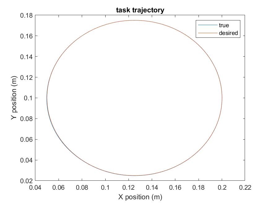

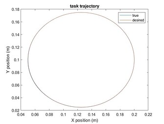

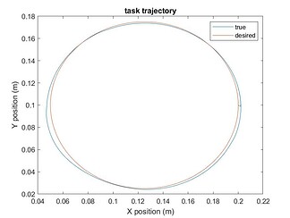

Here are some examples of PD vs PD + gravity compensation from a homework assignment I did a while ago. (It is a 2 link arm tracing a very slow circle. Fast circles look bad because there are other physics going on then just gravity)
This is cool but what kind of homework do you have??
Not totally sure what the question is. But that is the kind of homework you can expect from a “robot control” course. This style course would likely be graduate level, as mine was, but that is mostly because most schools don’t go into robot specific stuff until graduate school.

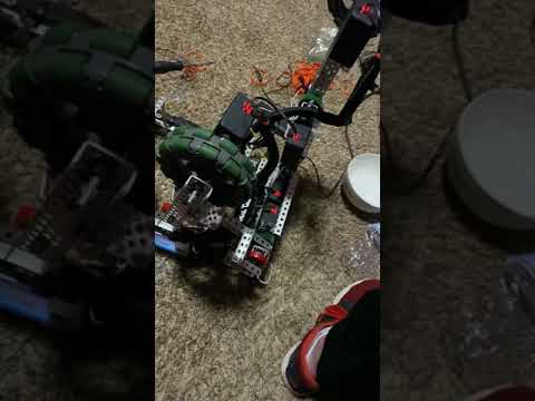

This video was some time ago before I added anti-backlash into the program, but you can get the gist about just how powerful this algorithm is. This is the gravity compensation without PID:
Oh wow, the weight negation alone has that much control? I’m curious to see the behavior with a rubber banded lift because the rubber bands add much more dynamic behavior. Maybe it dampens it oscillation even more which is a good thing (or so I’d assume).

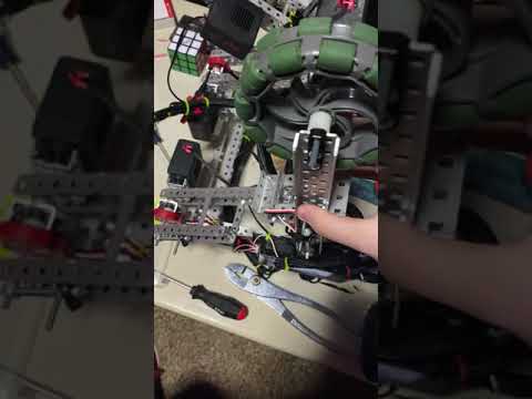

Here is proof of how insane gravity compensation can be. With a little maths, I am able to have doggy do gravity compensation based upon the sensor’s angle:
I disabled PID and kept gravity compensation enabled to show how the arms can hold their position even without a PID.
Or just put the motors on hold mode?
I dont think you understand what gravity compensation is. I would advise reading OP first.
