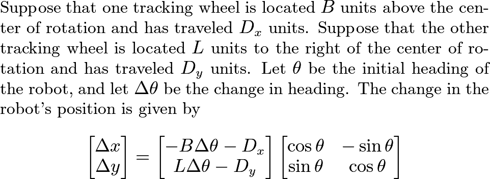

Odometry is tracking your robot’s position on the field using tracking wheels. Tracking wheels are encoders attached to them that allow you to measure how far they spin. Internal encoders on the motors work too, but they can be inaccurate.
That math lower down is the tracking algorithm (you can ignore the proof, but it is interesting), you will need to translate it to code, there isn’t code to copy and paste in (using V5.) The math isn’t really that complex overall, it just looks very intimidating when you first take a look.

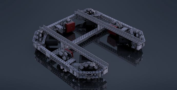

A tracking wheel is a non-powered wheel that is connected to a shaft encoder used to track the movements of the robot.
This picture shows how to mount a tracking wheel to the robot. This one uses a smaller omni wheel that I think is discontinued, but any omni wheel should work

The way 2-wheel odometry works is by using 2 perpendicular tracking wheels. Using the two perpendicular tracking you are able to track the local change in x and y over 5 ms. After that, we can use a conversion vector (some basic trigonometry) to convert our local change into global change using an IMU. This global change is then added to the previous position and we now have a new position.

Odometry is a way of tracking your robot’s position on the field accurately. It uses “dead wheels” that are on the ground and are not powered by a motor, and shaft encoders to track the distance those wheels move. All of the math is to convert from the movement of the three tracking wheels to a x and y position on the field. It is a more advanced algorithm used in Vex, and it’s probably overkill for a new team, so I wouldn’t do it to gain a competitive edge, but if you’re still interested in learning I recommend the BLRS article linked above for the math, and the youtube video linked above for understanding it. It can definitely be implemented in Vex C++, but it will be a lot of math and I don’t recommend doing it if you don’t have a solid understanding of trig functions.
