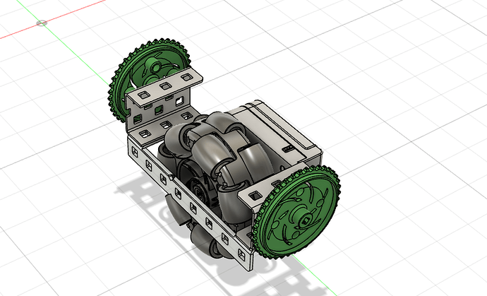

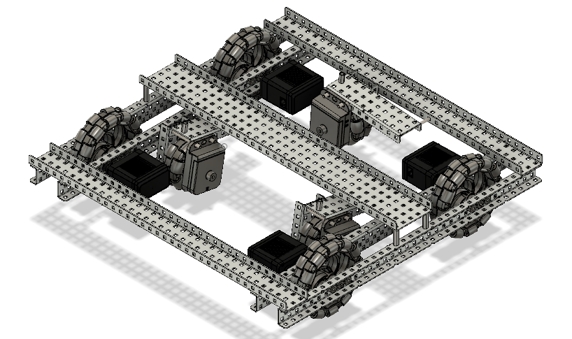

I’ve set up the forward/backwards odomentry wheels but I could find a reliable way to do the side to side wheel. Since I always need it to not move side to side while going down to make sure it always falls in the same place. I couldn’t find anything on how to do this on the vex forums.
I was thinking of using linear slide stuff but I know that can wobble a bit and setting up the track could be difficult to do it from 2 sides. (Considering I would have nowhere to brace it on for 1 side)

Are you thinking that you need to have the 3rd odom wheel able to move side to side within the robot? I’m confused why you’re getting into all this complicated stuff with sliders and chain. A picture or a CAD would be helpful to better understand what you’re trying to do
Okey heres my cad of it
I would just connect it to the other side of a chaing bar to make sure it stays level at all times. So If I’m off the ground there is no chance of losing contact because it will always stay level meaning no metal from the assembly could touch the ground either.
This should work and I have plenty of space to mount this on the chassis
It would be passive and default to the down state with rubber bands

the cad was of the side to side wheel
*I need to have it not move side to side
*Stay same rotation no matter how high it’s of the ground
So a setup like this should work. Also Slop won’t happen if everything is spaced out correctly
