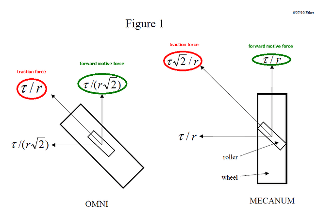

Now, comparing mechanum drive vs. x-drive vs tank drive, there is a lot more too it than just torque, you have to take into account direction. When moving forward, a mechanum based drive will have the same amount of torque as a tank drive because of their orientation (ideally). However, as @aryan.pradhan mentioned, the rollers are angled at a 45 degree angle, so when you are strafing the torque output is changed. In an x-drive, since the wheels themselves are angled at a 45, going forward, the amount of torque they output is much lower, but because of the kinematics behind it, they can go much faster.
Honestly, just like every year, the best drivetrain depends on your teams strategy. If you are focusing on match play, tank is usually the best option, as it has been just about every year. The simplicity of a tank base is also a huge benefit, and they are certainly easier to program. If you are focusing on skills, then an x-drive or mechanum drive would have much better mobility, but programming is more complicated. In my experience, it takes some more skill to build any omni directional base if you want it to drive/strafe straight. Another thing is that mecanums that we are allowed to use aren’t great, and because of frictional losses, they are usually the slowest of all of the different options.
