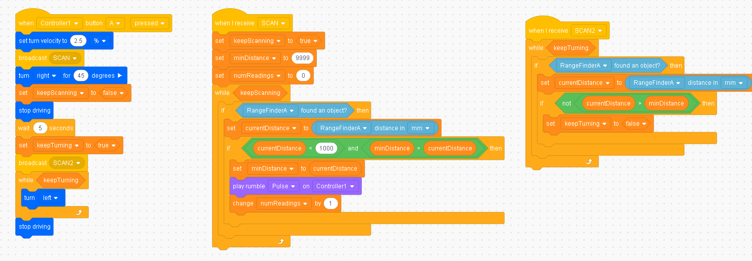

I’ve been playing with a 3-wire range finder with the idea of using it to locate a mogo and position the robot so that all it needs to do is drive forward a fixed distance to pick up the mogo. As a test, I’d position the robot ~2 feet away from a mogo and have the robot turn slowly to the left 30 degrees and then to the right 60 degrees, while polling the range finder and keeping track of the shortest distance it returns. My idea was that the shortest distance would correspond to the position of the robot where the mogo was directly in front of it. The idea failed in practice; my guess is that I didn’t realize that the range finder would emit a sound wave that resembled a cone and not a beam, and that it did that only 4 times a second. Would a V5 distance sensor perform better with the same code?

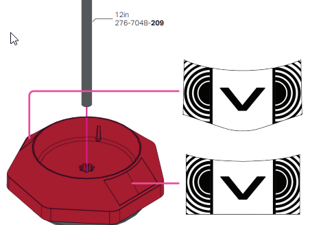

this is the reason for the colored sticker on the MOGOs
Oh, is this the sticker you’re referring to?
So you’re saying we could configure the sensor with images of a red/blue/yellow MOGO, and it’d locate matching objects on the field? Do you suggest setting up the sensor to look for those stickers specifically, or red/blue/yellow MOGO bases in general?
if you set it up to look for the goals from far away and look for the stickers up-close, you can grab the MOGO from a consistent angle. additionally, the yellow MOGOs should have the sticker aligned with the poles , which is good if you plan on scoring on the goal or can rotate a goal.
