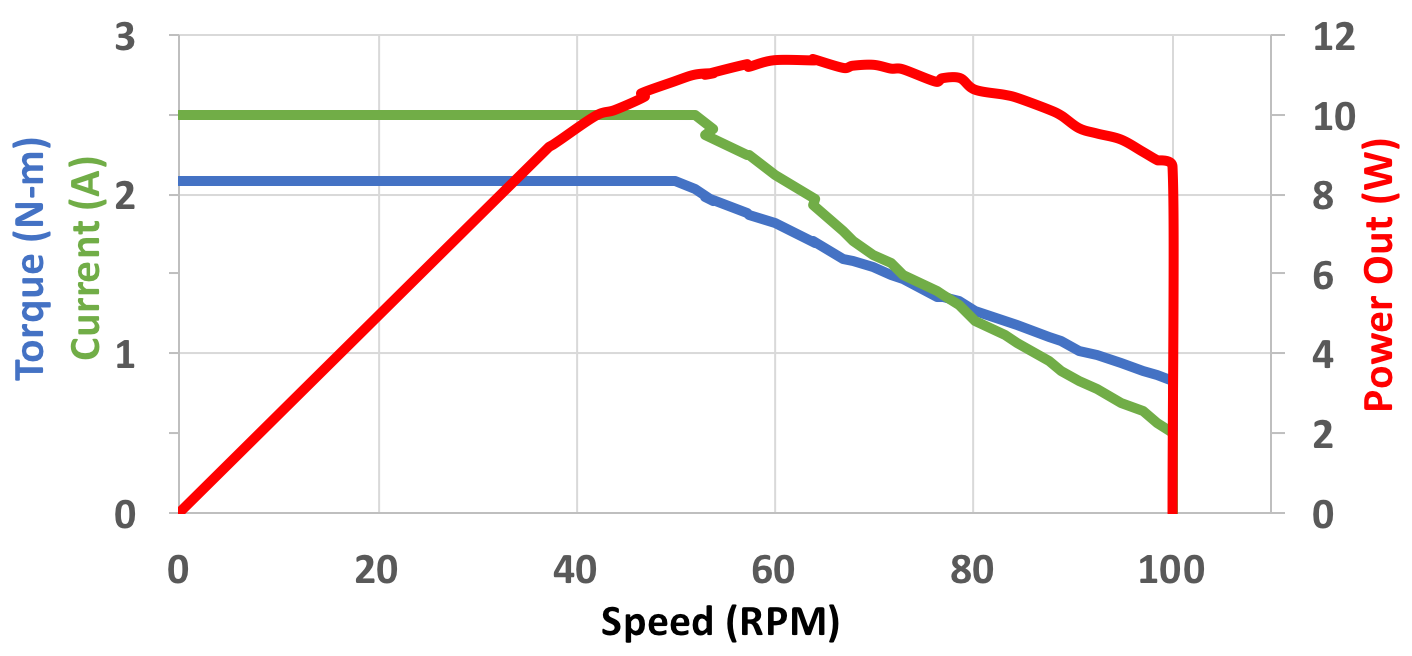

When I go into my devices on the brain and run the motro from there it provides you with a graph showing torque in Nm. When the motor is at 50% is when it shows the highest amount of torque. Am I understanding this wrong?
I don’t know what the brain is doing but motors use electromagnets to turn. The percentage of power is the percentage of possible electricity the motor can use . So at 50% the magnets are at 50% strength which means the motor is at about 50% of top speed and has 50% of possible torque
As you can see with this torque graph it is much more complicated than that
the X axis is the speed and the torque increase and the rpm or speed decreases and the power output is on the y axis
The thing to remember when looking at motor torque-speed curves, is that the axis showing speed is not the speed you are commanding the motor to run at, it’s the speed the motor is running at due to increased load. Here’s are the original theoretical curves we calculated for the old 393 motors many years ago. (which is drawn differently from the V5 curve above).
It gets more complicated with V5 motors, generally you are asking the motor to run at a requested speed and it is using closed loop control to try and maintain that speed, internally the motor will increase current (and therefore torque) as necessary until we hit the current limit (which may be reduced as the motor heats up). When using raw voltage control, it will behave more like the old 393 motor except we still impose current limits, that’s why the blue and green lines on the V5 graph become horizontal.
