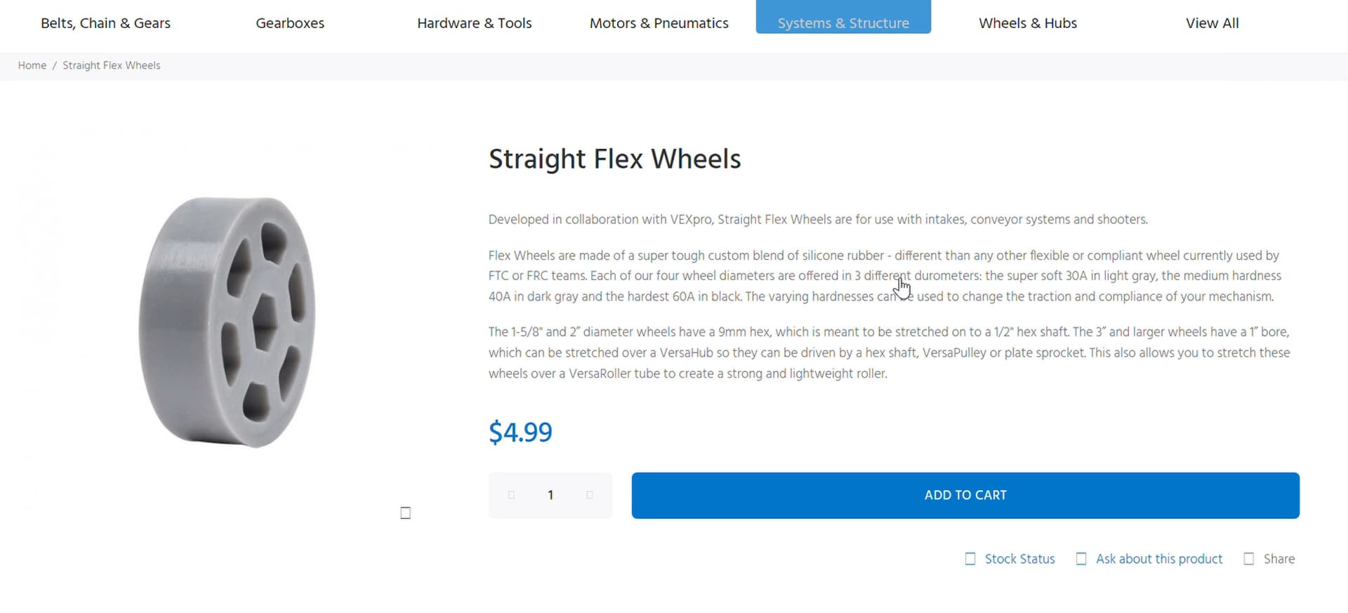

All right, after some emailing and digging around in the way back machine I am confident on my assessment on the legality of west coast products (WCP) flex wheels.

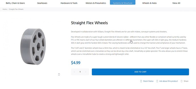

Up until either late 2023 or early 2024. The WCP product page looked roughly like this (some errors with the web page displaying properly so this is the best I could get):
These are the EXACT same flex wheels that vex currently sells as per the email back I got from WCP. Regardless of whether or not these parts are technically legal, there is absolutely 0 way to discern where these wheels were purchased from after they get mixed in with the vex ones. I know my old org 67101 has bought flex wheels from both companies and in order for anyone there to be 100% sure they are using legal parts they would have to throw out all there parts, which is quite unrealistic. I am sure many other organizations are in a similar circumstance.

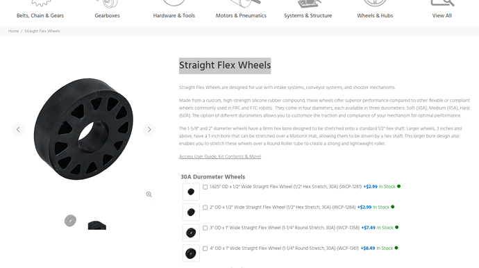

However, sometimes in late 2023 or early 2024, WCP changed there product page to the following:

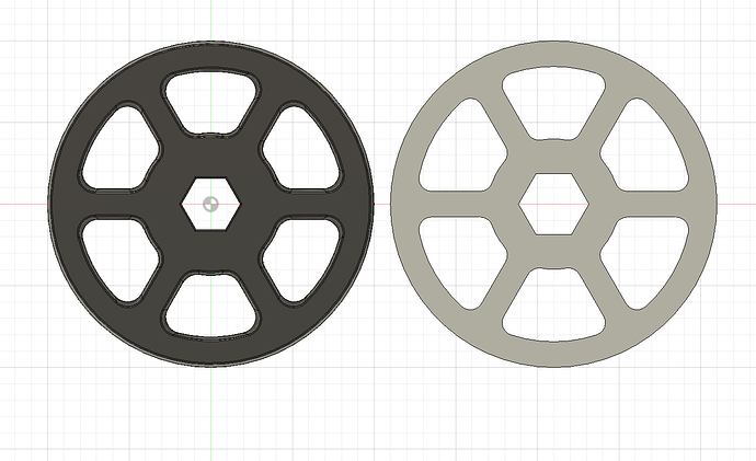

These flex wheels are NOT legal. they difference can easily be discerned. (WCP on the left Vex on the right, color may vary)
In the same email from WCP, they stated that had no plans to restock the VRC legal flex wheels.
Similar flex wheels from Andy Mark are not legal despite looking very similar. It is discernable with a keen eye though. (Andy Mark on the left Vex on the right, color may vary)
In conclusion, Vex is the only current seller of legal flex wheels. However, flex wheels purchased from WCP before 2023 are identical to the vex wheels in every way and using G3 (common sense) are legal.
