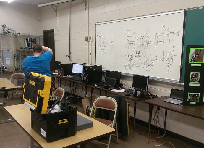

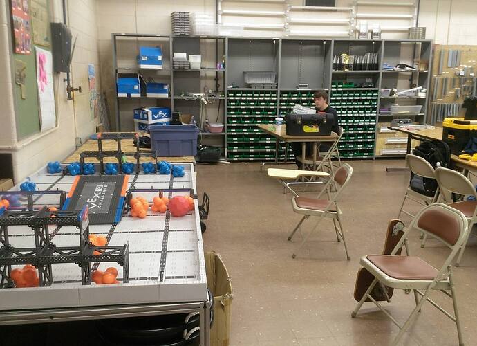

Here’s the VEX Team Virus lab space. About 35’ x 35’, two IQ fields and bin storage for all IQ parts, one EDR field (on a riser with storage beneath), parts bins and a metal hanging rack for EDR metal, workbenches for repair and testing, and 4 computer workstations. There are only 7 tables for teams to work at, so IQ meets on different nights/times than EDR, and our U-team like to work on Saturdays. We have access to a regular classroom across the hall if we need sit-down meeting space.

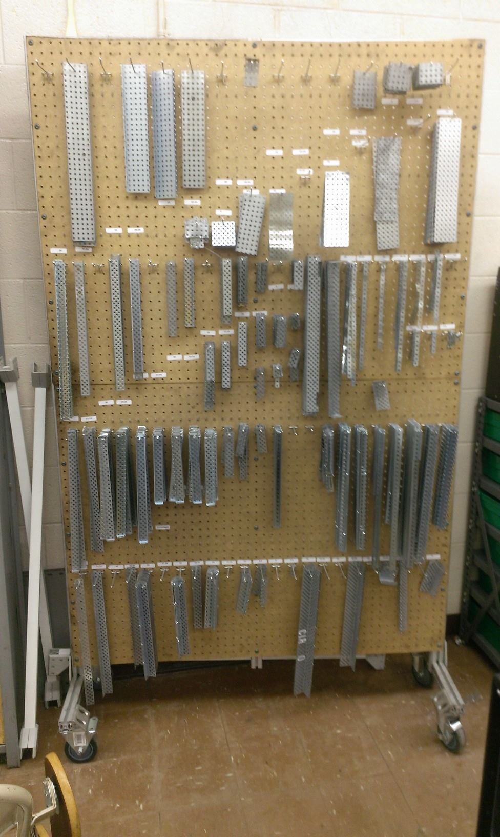

@kmmohn Nice lab! I really like how your field is elevated to provide storage underneath. Also I like your pegboard for organizing the metal. Could I get a close up of the pegboard so I can try to replicate?
Here’s a closeup. The pegboard measures about 3’ x 6’. The frame is made of some 80/20 t-slot and caster wheels that my company donated. Pegboard hooks are 4" long I found on ebay sold by the 100. They have to be the “smaller diameter” wire hooks to fit the vex metal. The hooks are tied to the pegboard with wire so they won’t fall out. For each type of part, there are labeled hooks as follows: 35, 31-34, 30, 26-29, etc. and we encourage cutting parts by 5’s. Steel is on the front, aluminum on the back, which is kind of a pain but it saves space.
Thanks for the detailed writeup! I’ve been meaning to try 80/20 t-slots, I’ve heard good things
