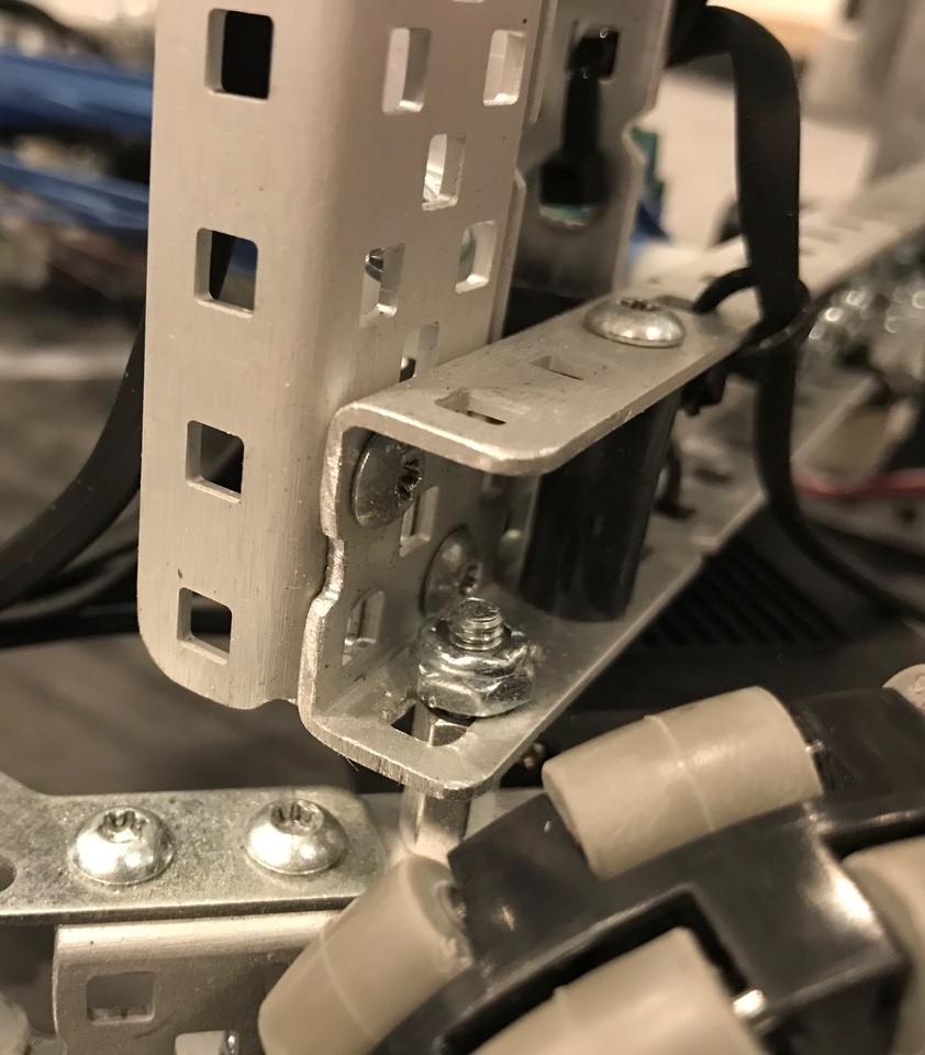

what advice would you give for attaching vertical beams to the chassis?
@Hao_16688C: Thanks! As for attaching vertical posts to a chassis, I’d say that it depends on the type of base you have. For VRC, it’s generally a good idea to use c-channels oriented in a way so that the flat sides are together with four holes directly on top of each other in a square. If you have a tank drive, you can probably use the bars you already have on your base as the horizontal. Make sure that both the horizontal and vertical bars are level, straight, and as square as possible, as well as spaced appropriately according to the rest of your design. Using at least two screws is a must! Personally I use two screws, one in each of a diagonal set of holes on the c-channel for stability but minimal weight. I’d recommend using nylocks. For additional stability if needed, triangle braces are good, although I do not have any of these on my robot.
With X-Drives, it’s a bit more challenging. In order for me to have a horizontal bar to attach the vertical posts to (in the same method as described above), I had to connect a c-channel across each side of the X-Drive. However, due to spacing issues, I could only have one screw on each end of the c-channel, and the holes did not line up, so I ended up having to widen the hole with a dremel. If you do this, drill as minimally as possible! This weakens the c-channel, but unfortunately, it was necessary for my design.
On a related note, think about the order in which you are building. Sometimes this requires some trial-and-error, but considering this beforehand can save you a lot of time, grief, and rebuilding. For instance, would your wheels or intakes hinder you from reaching the area needed to attach the vertical bars? This happened to me, and I had to temporarily remove my wheels and drive motors just to be able to get the vertical posts attached.
Here is a close-up of how I've attached the vertical bars to my robot.
I hope this helps! Let me know if you have any more questions.

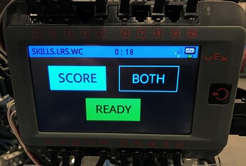

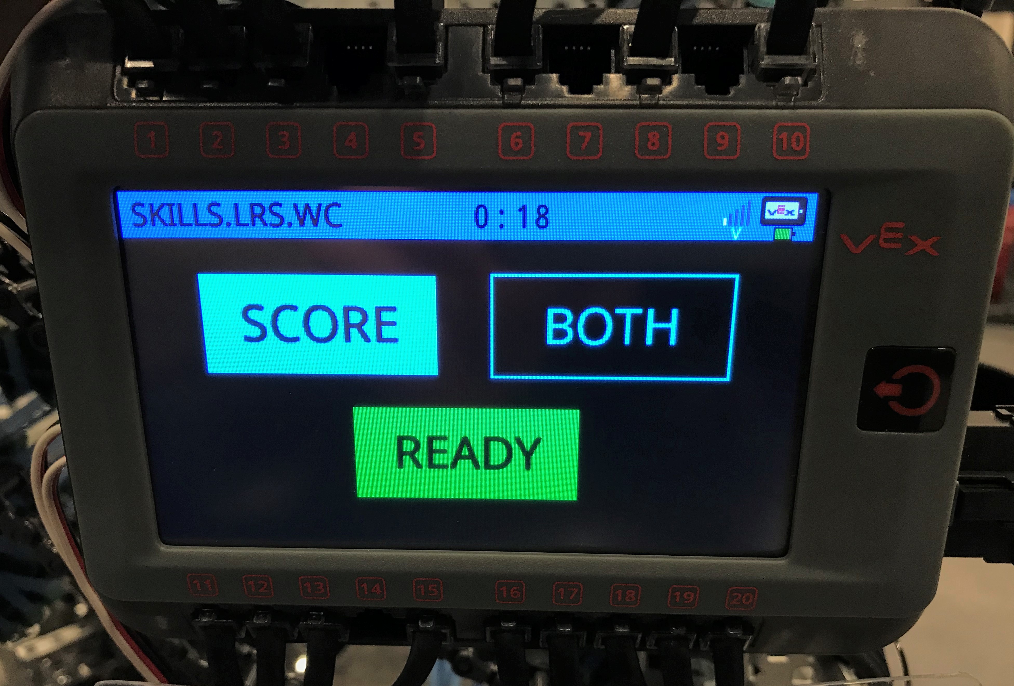

Brain Screen Autonomous Selector
I’ve gotten a number of comments about my Brain Screen Autonomous Selector. The programming for this can be found in my preauton function. Here is what it looks like with options “Score” and “Ready” selected:
