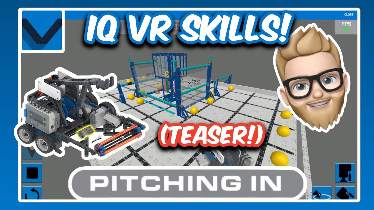

 Don’t forget that IQ VR Skills is live too! Check out this little teaser video I did -
