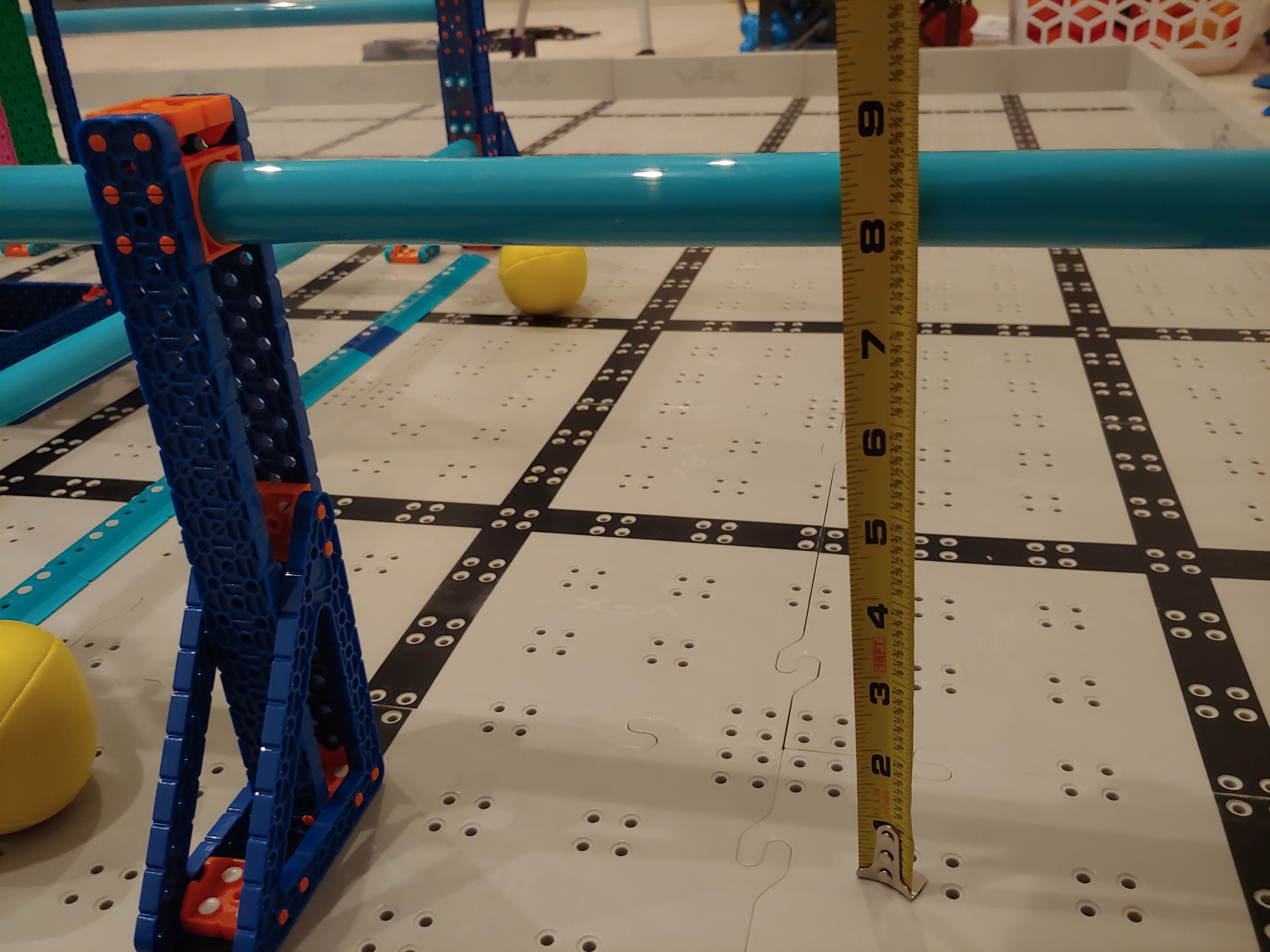

The measurement is from the top of the bar to the floor, correct?
Yes, that is correct. In case you were wondering, the bottom of the bar is ~7.6" off the ground.

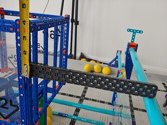

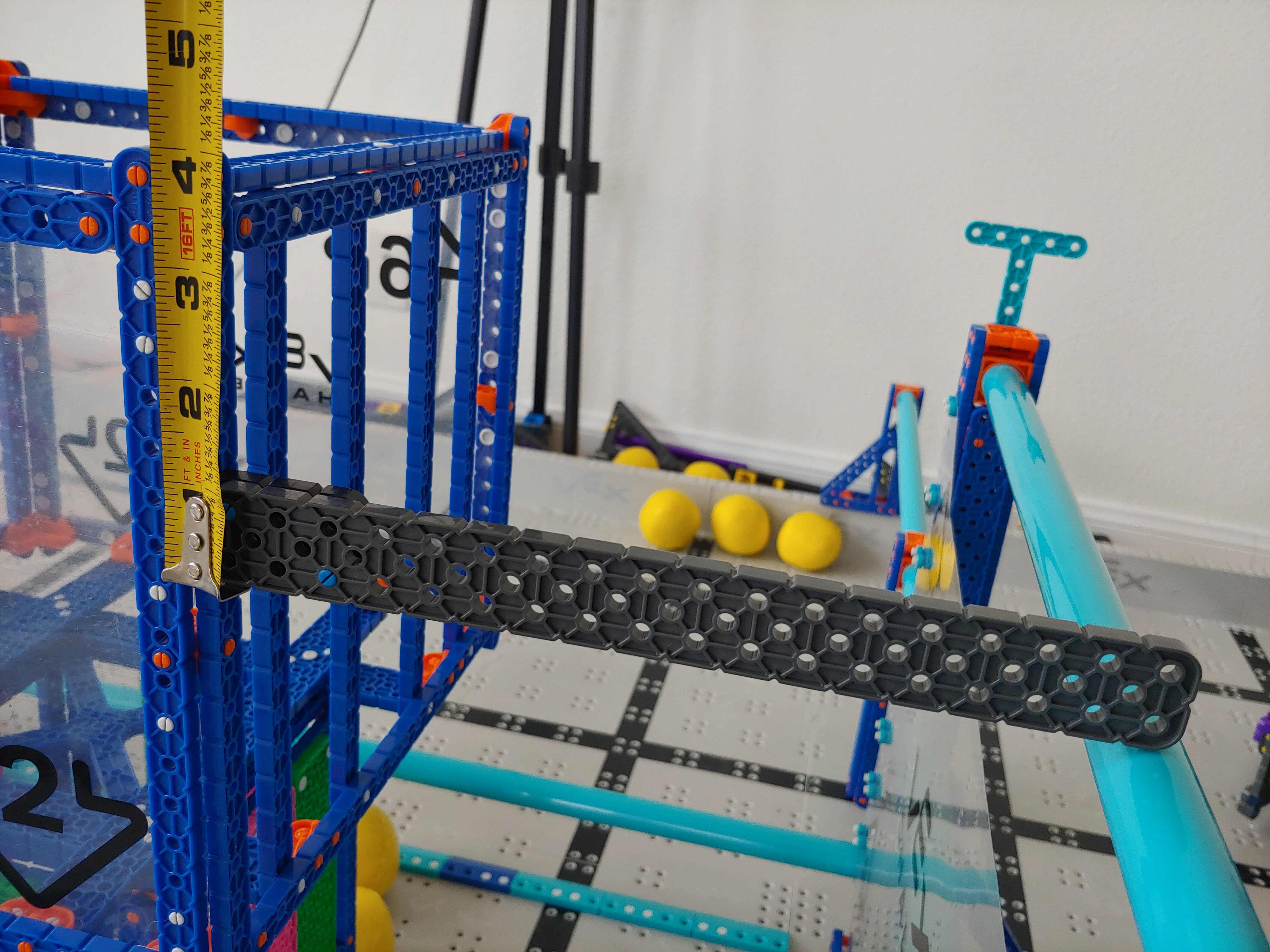

Can you tell me the distance between the high hanging bar and the center goal that we shoot balls into? Thank you
It is 4" from the top of the high bar to the top of the goal.
Just for reference, the top of the goal is ~20.5" off the ground, and the top of the high bar is ~16.5" off the ground. The bars themselves are 0.75" in diameter.
Thanks. I knew the height, I was just asking about the length but the 2x18 bar shows me that.

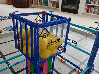

Hey, @FRC973 how much space do all the balls take up? Could you show a picture of all the balls in the top goal pls?
Despite what it seems like from the picture in the game manual, all the balls in the goal barely even fill it up halfway.
