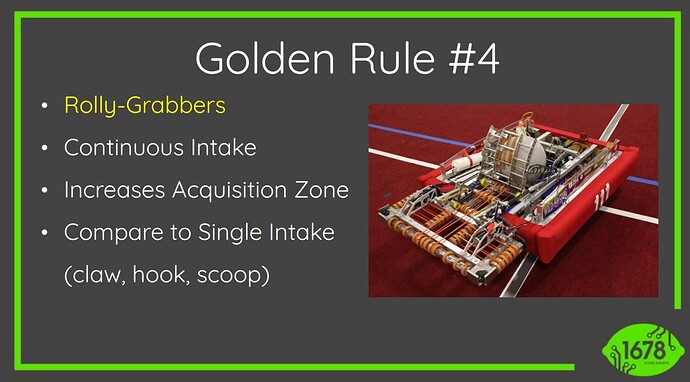

What do y’all think about a “cata-claw”? Basically a spin up catapult that has a claw attached to the end of it. This is so you can grab a match load with the claw, throw it to your alliance’s offensive zone, retract the catapult, and repeat. Plus it will eliminate the need for an intake system.
So basically, the claw would replace an intake?
