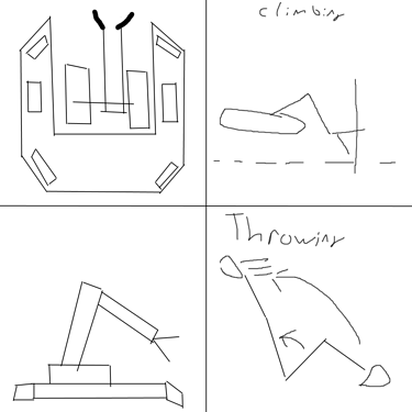

I’ve started brainstorming for this years game over under and I wanted to know if you guys had any ideas on it.
I drew this yesterday, I think it is pretty good.
4 motors for the X-drive
4 shared motors
  • 2 motors work to power the first stage and the right wheels
  • 2 motors work to power the second stage and the left wheels
  • power controlled by a PTO system so they can only power 1 at a time
    piston-powered claw
this design should last until mid season
I was thinking of using a double reverse 4 bar(DRFB). Mounting a claw to the part that expands upwards so not only can we pick up acorns, we can also expand and grapple onto the pole in endgame. I may be a wishful thinker but on the back we thought of using a solid plate to act as a de-scorer. I have no information about expansion rules so this is just stand-alone brainstorming.

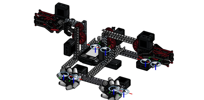

We were thinking of a modified clawbot idea.
Me and my team made a quick CAD model to get our ideas down. For anyone who doesn’t use onshape here is a picture:

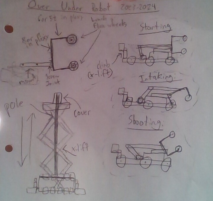

This was an idea we came up with on the spot.
It’s a good design but the only thing is that only one triball/acorn whatever you call it at a time. I do still believe this is what a lot of the less skilled teams will utilize because of its very basic design. Thank you and your team and your amazing design!
One of the things that I believe will be the most important part of climbing is getting your robot as close to the pole as possible. You might want to have your climing mech at a 45 deg angle while not in use then extend it out 90deg and then grab onto the pole and then finally pulling the mech back in, thus this time it will pull the whole robot towards the pole thus lowering the center of mass and putting less torque on the contact points of whatever climbing mech you are using.

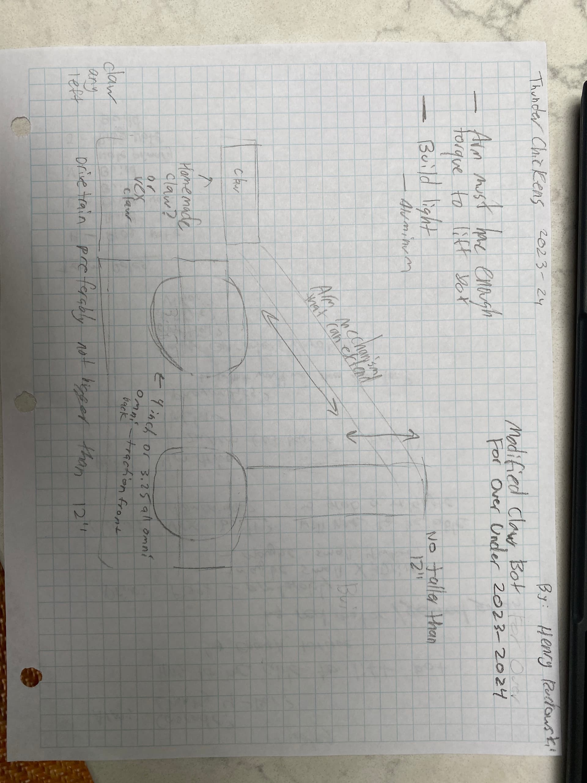

4 motor 6 bar lift with a 2 piston claw for both elevating and getting the tri-balls. Good Idea?
The strange shape of these game objects is going to be a major issue, I was thinking a large rubber band roller and a linear puncher with a “cup” attached to it. 6 motor drive seems really viable this year, it may even be possible to have 8 motor drive.
Yes thats what were doing
