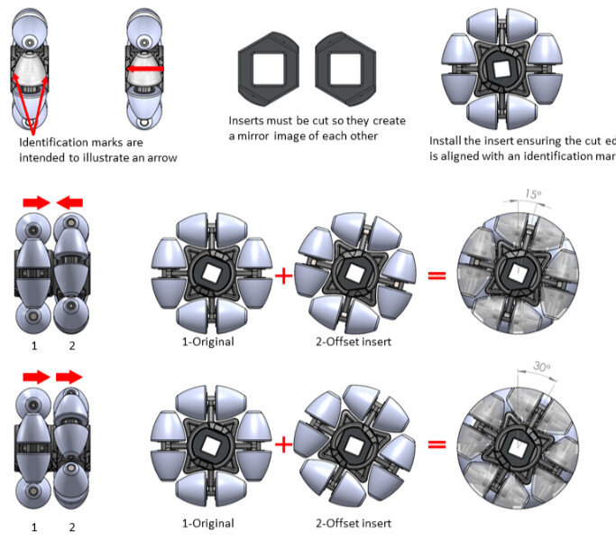

We use the 2 inch omnis, on this bot
It works out really well for us.
You mean 2" not 2.75" right? Also do you have any issues with it?
We dont have any issues with it, and yes it is the 2 inch wheels, not 2.75.
Just curious but do you double stack them to decrease squishing into the foam on the field.
what gear ratio do you use? I’m curious about your design as there aren’t many other 2 inch omni users out there.
For the @Alex3D question, we run 8 mecanum 2 inch wheels, so we dont double stack but dont sink either.
For the @sixtonpotato question, we run 600rpm direct.
How does that work for strafing? Is there any friction due to the mecanum wheels’ rollers not intersecting at the same point?
The strafing is great, especially with the 5.5W motors allowing for 66w drive both holognomically and normally, and we set it up so that each pod has as its set of 2 wheels as close together as possible to try and negate any bad effects, which is working very well for us.
