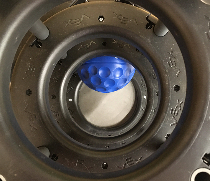

Ball lockout - critical flaw in game design?

False. Increasing clearance by shortening the “front” posts and raising the second ring will fix the “problem” of the ball’s clearance coming out of the goal, but it does not prevent balls from being “locked”.
(In this scenario, the “locking” of the balls can also take place as a result of pressure from the goal. However, by increasing the height of the second ring, balls can still be pushed into the same position, and with two others on top, as in the picture originally posted, they cannot be easily removed.)

Not false. The ball is wedged between ring 1 (bottom) and ring 2. Increased clearance will prevent 95% of this problem.
The pressure from stacked balls is trivial compared to pressure/friction from rings 1 & 2.

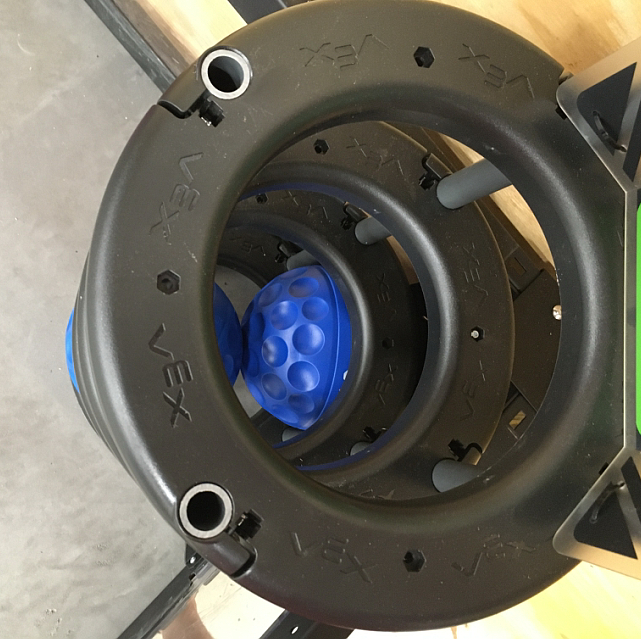

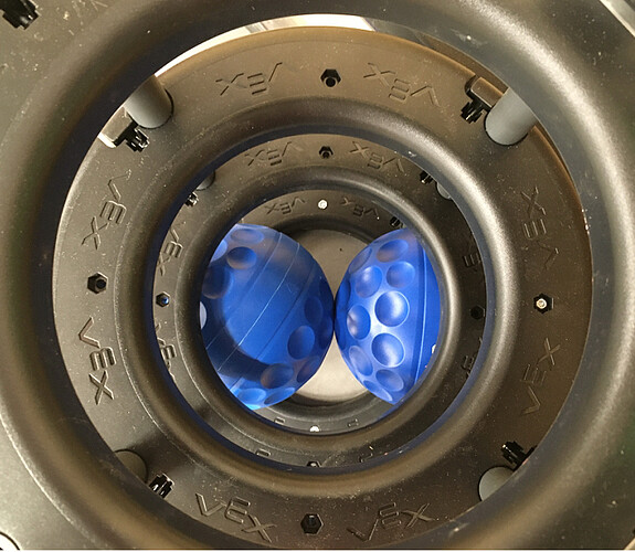

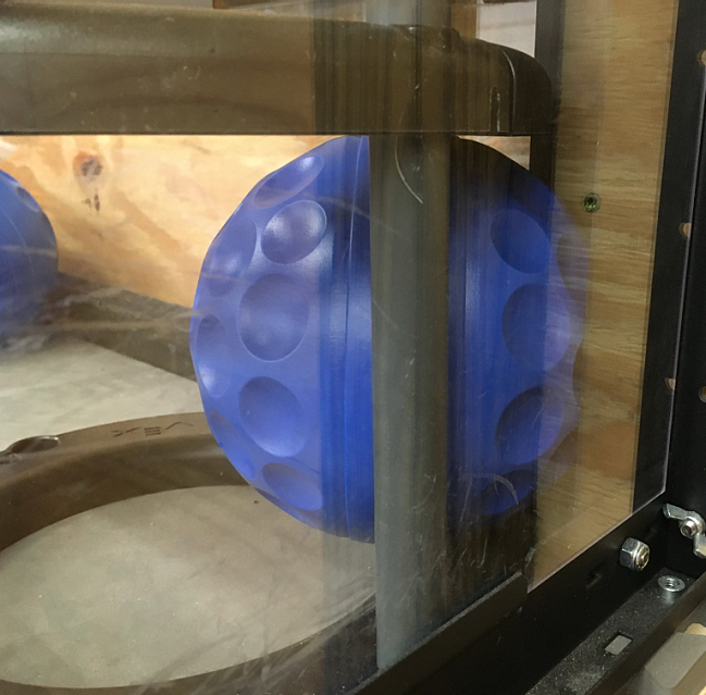

I need to post some additional pictures… the one I put up does not show just how far back the ball actually is. It also does not show just how little clearance there is to grab onto. BRB.
Can you test if a knock into the field wall will get them unstuck? I feel like that might work.
Nope. They are firmly wedged between the first and second rings.
Oh ok. (202020202020)
If they get pushed back ‘just right’ they are hard to remove BY HAND.

The simplest fix is to run a long 10-12" zip tie between the posts on the back. This will prevent the balls from getting pushed in and stuck in the corner.
