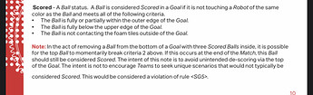

This is against the rules. The ball must on the field of the goal. And follow this:
What do you mean against the rules? That just whether or not the bottom ball is considered scored.

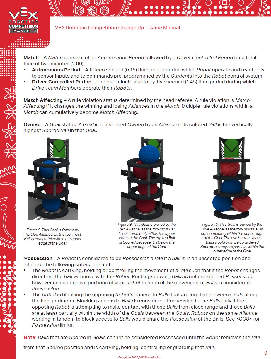

First of all, this page of the manual that you posted says nothing about balls being scored in goals, and second, this is currently legal, and the balls that are in this position are considered scored.

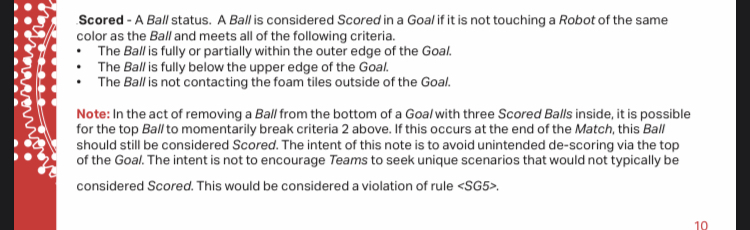

Please pay close attention to the three pictures, especially the position of the ball at the bottom
That bottom ball layout causes the top ball to not position properly. What is being talked about is how this actually makes the top ball be positioned properly.
You are talking about how goals are owned, not scored; two completely different definitions.

Yes, but you put the ball just like the third picture, you can be scored.

I’m confused on what you’re saying; a ball in this position is considered scored. And it even can be considered owned in a goal if there are no balls above it.

the definition for a scored ball is as follows:
  • The Ball is fully or partially within the outer edge of the Goal.
  • The Ball is fully below the upper edge of the Goal.
  • The Ball is not contacting the foam tiles outside of the Goal.
the wedged ball meets all of the above, therefore it is scored.
