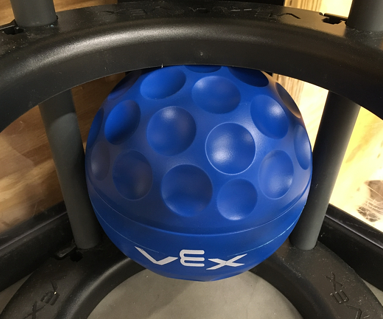

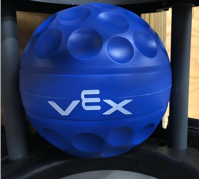

It occurs to me that in order for the balls to be wedged like this, the balls must be of a smaller diameter than 6.3" (and @turbodog you said so yourself in post #3, your balls’ diameter at the seam is 6.1", more than the given 0.1" margin of error).
Perhaps this is the problem, as @turbodog has measured balls to be off by greater than the margin of error stated in appendix A. (Again, refer to post #3). This problem has clearly resulted in others, but maybe there is a fix?

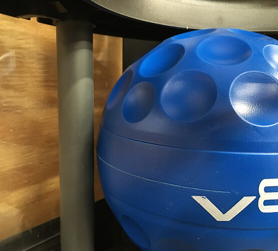

If you carefully look at the pictures, the balls do not reach the halfway point, they wedge before this, before the diameter reaches its maximum.

Very little clearance between ball and back pipes. Maybe like 1/8" or 1/16".
We put a screw into the side of the ball, tied a string from the ball to a 4m bot, and pulled. Ball came out at about 3/4 throttle.
The angle from the ball to the pipe does not allow a lever to function. You will hit the side wall well before the lever does much good.
what kind of tire @turbodog
Omni. Wheels did not spin.
geared 1 to 1 i assume
Or like .016" :slight_smile:
https://youtu.be/VPyggYPpQZU
5 second video showing jamming ball into corner
wow thats a lot easier than i originally thought
